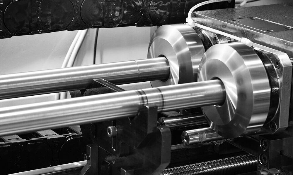

When considering the machine tool automation aspect,  an automation-ready design is critical to provide a solid foundation for process-wide automation. For deep hole drilling machines, that starts at the core of a machine’s design with its axis plan and spindle movements.
Other automation-ready machine aspects include automatic doors for automation access, communication capabilities in the controls and sensors, and other features and capabilities specifically made to interface with or supplement automation.
In the case of deep hole drilling systems, a shop may manually load a part, but the machine’s underlying design allows it to automatically lift and nest a part into a fixture, set the tool offsets, drill a hole and send it back to the nest for unloading – all with perfect accuracy and repeatability.
