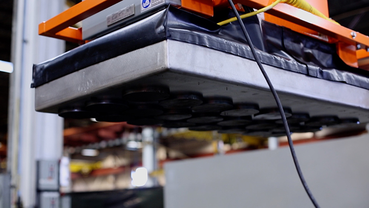

Permanent lift magnet.
Lifting magnets add safety and efficiency to cutting table operations. Above, an Eriez full coverage lifting magnet lifts parts cut out of a burn table.

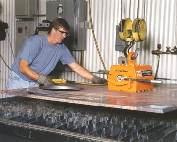

 Permanent lifting magnets lift and transfer a wide variety of iron and steel parts without slings, hooks or cables.
Permanent lifting magnets lift and transfer a variety of iron and steel parts without slings, hooks, or cables.

1. Lever-Operated
A lever-operated permanent lifting magnet, the most affordable option, is effective for handling single parts. Manually operated permanent lift magnets offer high capacity and versatility in their size and cost. They are available in both rare earth and ceramic.
As the operator flips the lever, the internal magnetic elements align to force magnetism into the part to lift it or pull the magnetism out of the part to release it.  Manufacturers include handle locking mechanisms to prevent accidental part release. Some models have carefully designed circuits and levers that minimize and handle the backlash.

3. Full coverage
Full coverage permanent lifting magnets take the automatic, hands-free operation to the next level as they can clear large areas of cut parts from a burn table in a single lift. Full coverage systems are designed to handle cut parts and skeletons as well, depending on sheet and table size. Full Coverage Magnets only require an overhead hoist and air or electric supply for system activation.
These powerful systems utilize a large full-contact magnetic surface area, with no gaps in coverage, to unload the table quickly and efficiently. Production facilities looking to gain maximum torch time can drastically reduce loading and unloading time and keep operators off the table by utilizing a full coverage system. The ceramic magnet circuit can withstand material temperature fluctuations and alleviates power failure concerns.
