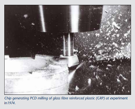

Between 1974 and 1976, polycrystalline cutting materials, such as PCD and PCBN, could show their potential for the first time. As a result of the hardness of diamond, combined with the sharpness for machining tasks, the superiority of PCD was displayed early on when turning, milling and drilling.

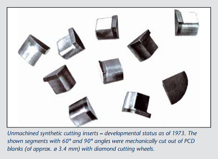

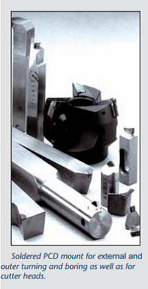

PCD tools had been developed based on the earliest requirements and focused on the use of turning tools with soldered cutting segments with 60° or 90° angles. Even though milling with PCD was already a highlight of the Hanover trade show in the spring of 1974, its use was limited until the end of the 1970s to carbide plates, which were clamped into cutter heads. They consisted of a soldered PCD cutting edge and small-shank tool with at the most three cutting edges.
We have to consider that all then-available PCD cutting edges had to be tediously cut out of a 3.4mm or, at the end of the 70s, a 6.4mm blank, which left only little scope for spectacular depth or width of cut. Furthermore, the prevailing textbook opinions about diamonds were still in too many heads during this phase: “Diamond is only suitable for polishing gold and silver and some nonferrous metals, but by no means suitable for uninterrupted cuts.”

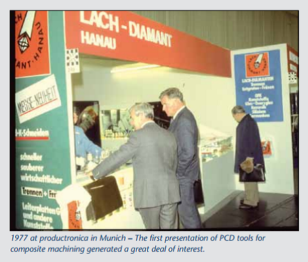

Of all things, the announcement of a show, which was until then unknown to me, in hindsight proved to be a turning point for the implementation of PCD tools. The productronica, in 1977 in Munich, announced as a component show for the electronic and circuit board industry, caught my attention. Circuit boards? The basic material is glass fiber-reinforced plastic, which is something we know. We had successfully cut this with PCD, even dust-free.

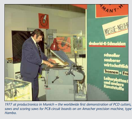

To demonstrate this successfully at the trade show, a demonstration machine was needed. We found it at AEG in Seligenstadt, where the company manufactured circuit boards for domestic use. It was a Swiss-style machine from Amacher. Three processes could be shown on this small, precision machine, type HAMBA: cutting, scoring and edge machining.
We registered for the show. We placed an internal work order for the three PCD tools, or rather saws, we needed. The only objections were raised by production: “How are we supposed to grind these rotating tools? It will take forever.” Indeed, to finish 12 teeth, for example, it took 35 hours of grinding time! But I said, “You can do it. You always found a way in the past.”
The productronica 1977 was at first a huge success for Lach Diamant. At the time, there was a growing demand for electronic circuit boards, and all the big names were present and gathered around the small Amacher machine to marvel at the precise and dust-free machining of PCB, the basic material of circuit boards. I still remember to this day, the doctors of Siemens and NCR, who immediately thought of diamond saws for packet machining of 300mm and 350mm diameters and who spontaneously ordered sample for further experiments.

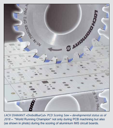

It could have been so perfect. Machining of circuit board materials would have already been possible in a more efficient way since 1977 if only the following would not have happened: “Boss, we really do everything for you, but we can only do one thing. Either we can try to make scorers and saws for circuit boards, or we can continue to serve customers, like Bosch and Kautt & Bux with commutator diamonds.”
That was it for rotating PCD tools. The “grinding” technology delivered only 12 PCD teeth in 35 hours; the facts were very clear. The initial trade show success was gone.
