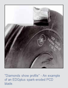

It is October 1978. On Oct. 13, my discovery at the former Matra company in Frankfurt that PCD can be eroded by means of electric sparks was registered at the patents office. In October 2018, we looked back at 40 years of experience in the application of spark erosion for manufacturing and versatile application with polycrystalline blades of PCD- and PCBN-tipped tools.

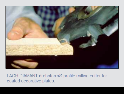

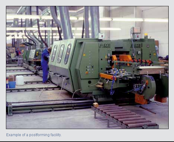

Mr. Denker continued: “We call it an American milling cutter with profile for a post-forming work plate, with a cutting width of 45mm and a cutter diameter of 160mm.” (All checked and still shown in old documents at Lach Diamant.)
When the cutter dimensions were mentioned, my reply was “But, unfortunately, our production is not yet ready for this size.”
Denker replied: “It doesn’t matter. We are sending you two Leuco milling cutters with carbide blades and you simply take those off and solder on your diamonds.”
The conversation went that easy. However, it was so pivotal for the future of this cutting material, which was still in an early development phase, and for us as tool manufacturer and user, as well as for manufacturers of superabrasives, such as General Electric with its “compax” and “BZN” products and DeBeers with its “Syndite” product.

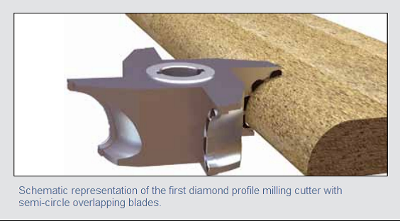

On the following morning, Günter Hobohm picked up the two carbide milling cutters. Now the carbide cutting edges were removed, cleaned, diamonds attached, cutting width was 45mm—oh gosh—there was a problem. The largest insert blanks at the time offered by GE only had a diameter of 13.2mm. We decided on a semicircle cut, so that a blade length of maximum 13.2mm was available. We had to add pieces. The inserts were only 13.2mm long and had to be soldered on in an overlapping way, tooth by tooth, to avoid creating scoring marks during the milling process.
Manufactured this way, the world’s first PCD cutting tool for machining wood materials (post-forming—coated as a kitchen cabinet plate) was manufactured as Z =4, but due to the necessary overlapping, this diamond milling cutter was really a Z-2 tool.

Being an attentive reader, possibly an expert, you are right. At the time, this was not as easy as “soldering,” for example. Already the first diamond too, for milling on a double-end tenoner was a monoblock tool, resulting from the carbide tool bodies given to us, thus no cassette tool.
Again, another coincidence, or let’s rather call it a stroke of luck since the PCD cutting edge, starting with the very first milling cutter, was already prepared for the long tool life of the future compared to all other materials. Ultimately, profiling prepared PCD cutting edges was “child’s play” for us, because the company Matra did that on a FANUC wire EDM. For this reason, we are still very grateful to Mr. Schreiber and Mr. Becker.

Finally, on Jan. 5, 1979, we could report success. Günter Hobohm and I took the opportunity and personally delivered two firstlings to then watch the first use. I don’t necessarily want to say that we were shocked when we saw the big “monster” of a post-forming system—a double-end-tenoner. But we both were astonished. After mounting the cutter, the system started with a load roar and a few thoughts were going through our minds. “What happens now? Do the cutting edges hold up? Does the soldering hold up?” But all went well.
Before we went back home to Hanau, we asked “What do you think; how long will they be running?” We could have expected the answer “You are the specialists. A carbide milling cutter lasts approximately three to four hours, then it has to be resharpened. We work three shifts. Therefore, diamonds must hold up a bit longer, at least a week.”

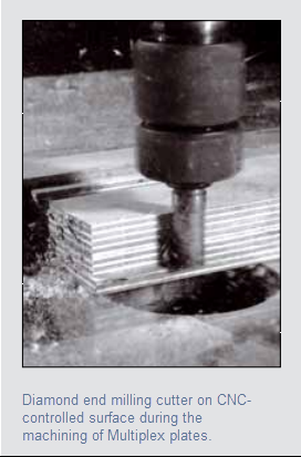

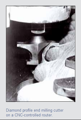

As so it happened. A dreboform PCD endmill, type FZ24/20, shaft 12mm, øx20mm, with plunge cut, was used. It machined veneered chipboard on a CNC router made by MAKA at 17,900 rpm. Performance tested in practice at 30,000 rpm. A maximum of 100 milling operations were achieved, with a comparable carbide tool. Also, a 300 times higher lifetime compared to carbide.
Yes, I can already predict that lifetimes of diamond tools for machining wood and plastics will play out at 250 to 300 times longer compared with the average possible performance of a carbide tool. There are many positive factors for this new technology and for the start-up company Lach-Spezial. It should finally be seen at the worldwide first presentation of diamond tools for machining wood and plastics at LIGNA 1979.
