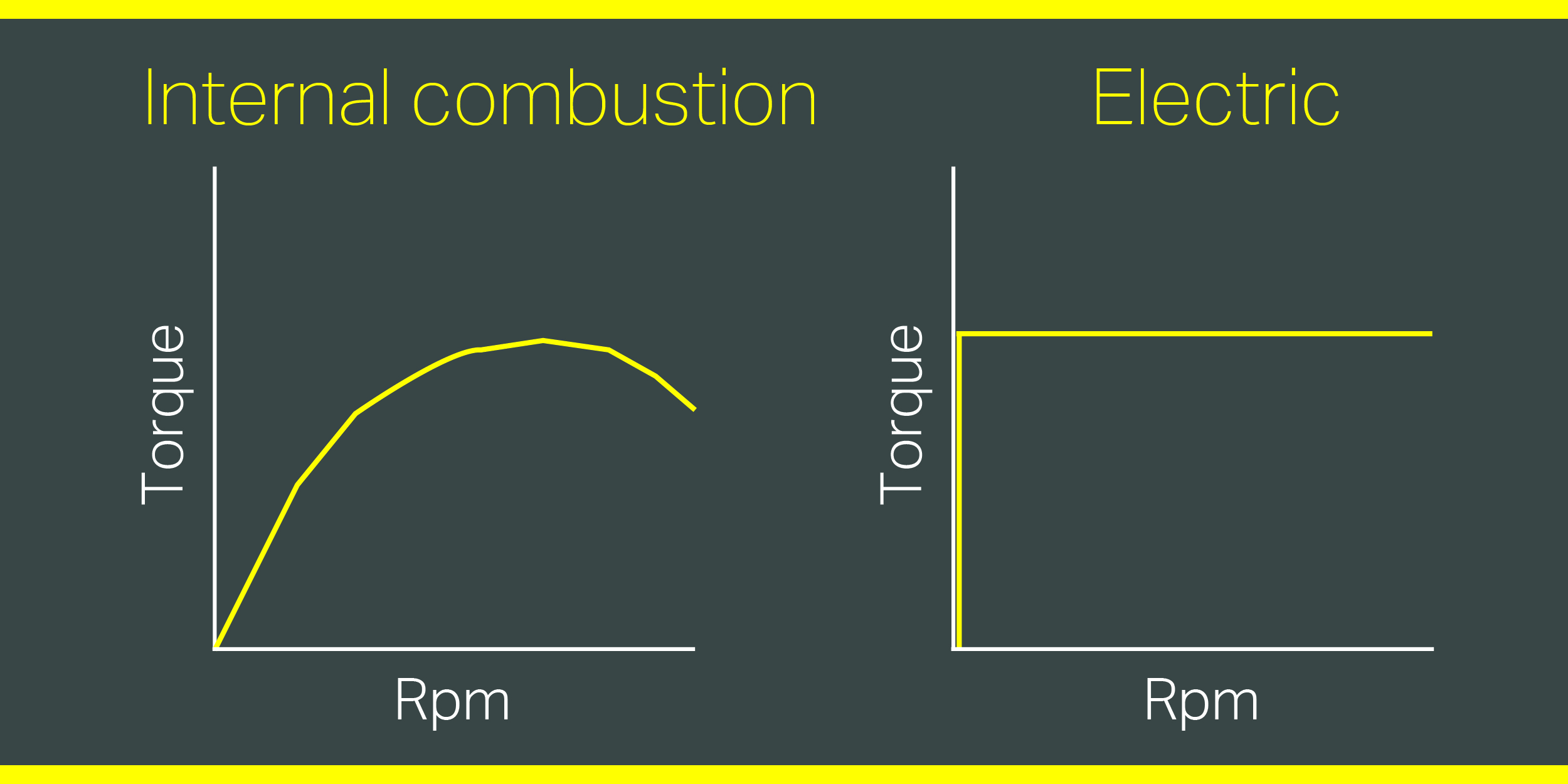

There are two main reasons why EVs need to have transmissions (Figure 1). First, the torque/revolutions per minute (rpm) ratio is not the same in an EV as in an internal combustion vehicle. In the EV, it is hard to achieve torque/acceleration from the battery without a transmission. The high torque puts higher loads on the gear flanks and, together with high rpms, this brings noise reduction into focus since EVs don’t have an engine to cover the noise.
Second, the higher rate of rpms in EVs puts higher quality demands on the transmission, which makes it increasingly difficult to use conventional machining methods. That includes when machines are standing in a line, adding deviations to the gears every time the gear component is moved to the next machine. The EV transmissions are mainly planetary transmissions where the compact design also reduced weight and space needed for the transmission. Some transmissions are also called reduction transmissions, since the task is to reduce torque and rpm at the start.

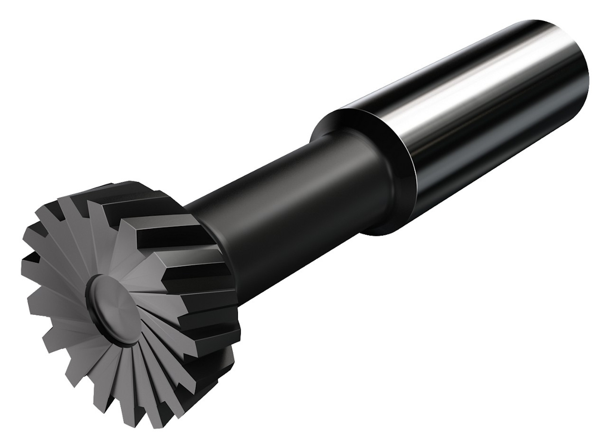

A Sandvik Coromant customer put power skiving to the test when it sought to shape main gear components made from low-alloy 16MnCr5 steel using the Sandvik Coromant CoroMill 178 or the indexable CoroMill 180.
The workpiece would be subjected to roughing and finishing with CoroMill 178H PM-HSS solid power skiving cutter. Previously, the customer used a shape cutter for this process, run at cutting speeds of 40 m/min (131 ft/min) for the roughing stage and 50 m/min (164 ft/min) for the finishing stage. Using this method, speeds could be increased to 250-300 m/min (820-980 ft/min) for both roughing and finishing.
Overall, the manufacturer applied the CoroMill 178H PM-HSS cutters to three-to-five steps for roughing and two steps of finishing. The customer also reported a reduced tool set-up and indexing time, increased process stability and improved component quality. The quality improved because there was no need moving the component between different machines/machining operations, adding center deviations and run out deviations. The complete machining was made in one set-up.
What’s more, by replacing the time-consuming shaping process with power skiving, cutting time was reduced and tool life increased. This equated to a 90% reduction in machining time, leaving the customer with a large amount of valuable free capacity.
Tool options from Sandvik
Sandvik Coromant offers a series of carbide cutters for power skiving, CoroMill 178S, and also CoroMill 178H made from powder metallurgical high speed steel (PM-HSS). They are designed for extremely high accuracy and performance and are available for module 0.5–6 (DP 50–5). Sandvik Coromant also offers CoroMill 180. This is an indexable insert cutters with railed insert seats, for excellent and repeatable accuracy in modules ranging from 2.5–8 (DP 10–3).
