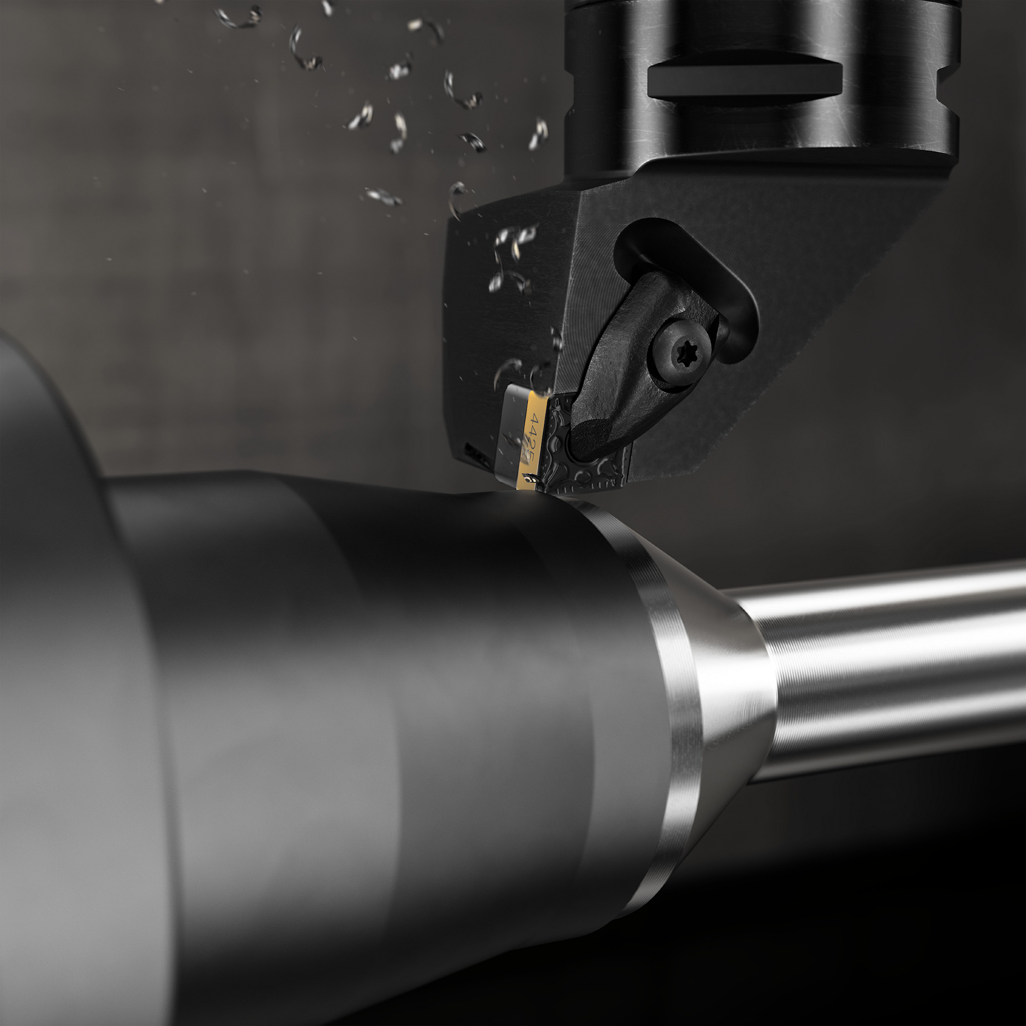

Several factors can stop manufacturers of steel components from reaching the desired number of workpieces per shift, not least the wear resistant properties of the tool. This particularly applies in the ISO P15 and P25 application area. ISO P15 and P25 refer to the demands that different working conditions impose on machining parameters. They include cutting data, surface finish, depth of cut, machined or rough surfaces and continuous or interrupted cuts.
It’s in this application area that carbide inserts with superior wear resistance are vital for supporting unmanned, or even lights-out, production.
But, what do we mean by wear resistance? There are different types. For instance, fracture resistance is paramount, as is a cutting edge capable of resisting plastic deformation induced by extreme temperatures. Also, the insert coating must be able to prevent flank wear, crater wear and edge build-up. Crucially, the coating must also adhere to the substrate. If the coating fails to stick, the substrate is exposed and this can lead to rapid failure.
To avoid these wear phenomena, the key is to limit continuous, controllable wear and eliminate discontinuous, uncontrollable wear. This isn’t easy, given the current trend for machining with limited, or no, human supervision — but several technologies can be advantageous. Predictive and preventative maintenance are often talked about, like intelligent software and sensors that can be the ‘virtual eyes and ears’ of a machine and support with optimal recommendations to match deteriorating tool performance.

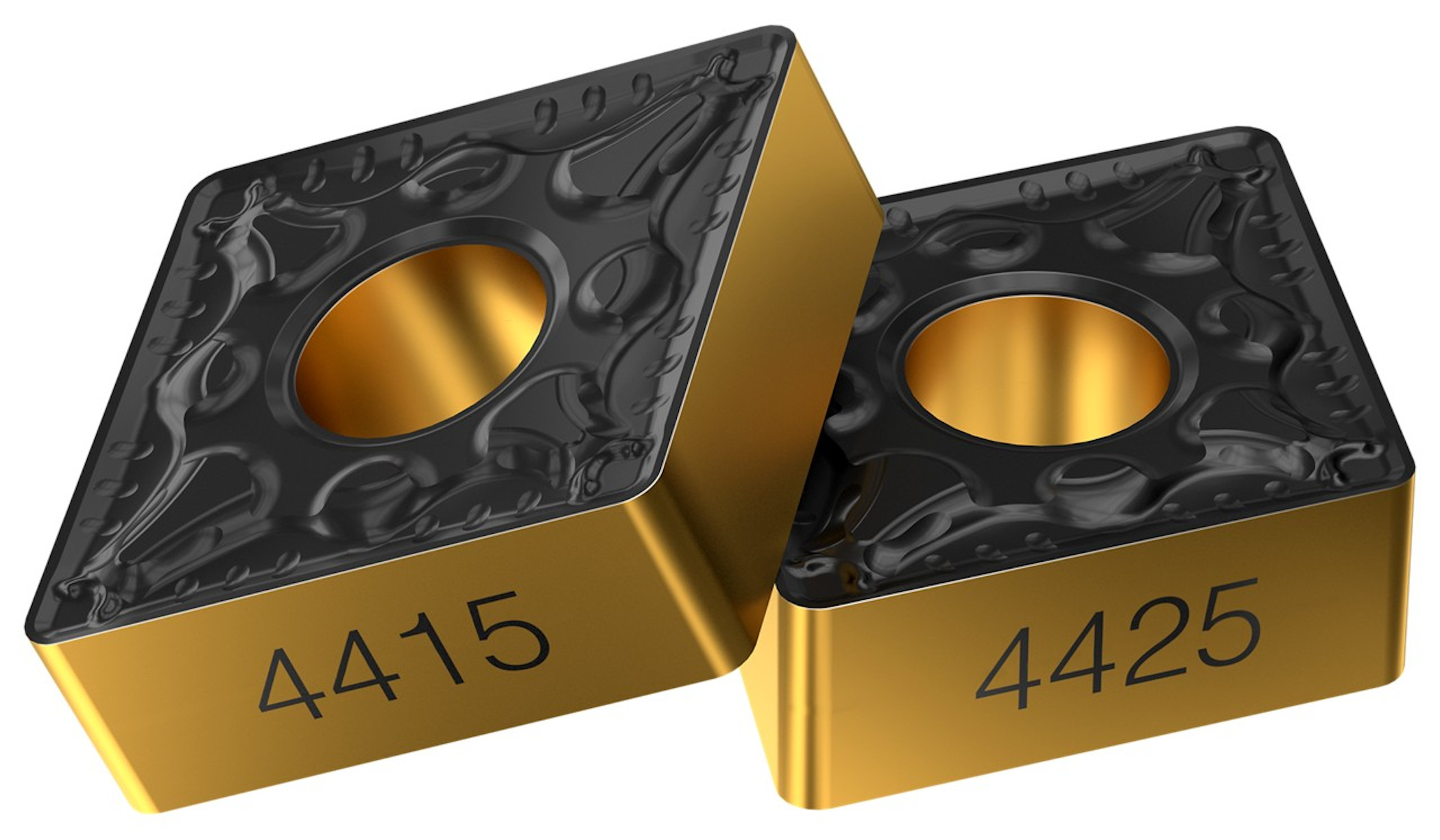

To achieve minimal wear, it’s vital to select the right carbide insert that can deliver consistent and predictable performance. This is why  Sandvik Coromant has launched a pair of new ISO P-turning carbide grades in its range, GC4415 and GC4425, which are each designed to deliver improved wear resistance, heat resistance and toughness.
In particular, both grades are ideal for use with low-alloyed and unalloyed steel. They can machine a larger number of workpieces and contribute towards extended tool life — in both mass and batch production setups.

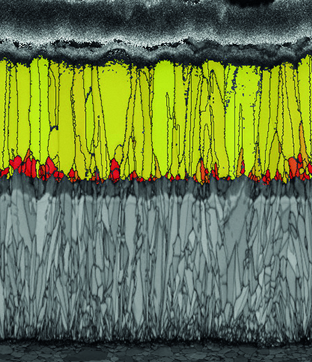

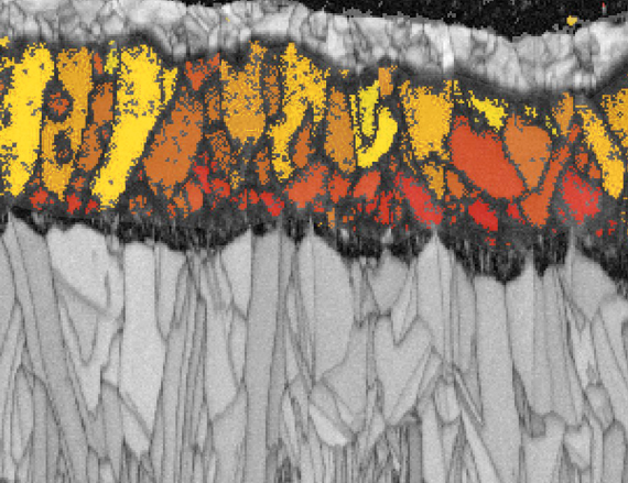

The GC4415 and GC4425 grades — which refer to P15 and P25 — each contain the second generation Inveio technology. Inveio is a uni-directional crystal orientation in the alumina coating layer, with unique properties that can be seen by examining the material at a microscopic level.
Every crystal in the alumina coating is lined-up in the same direction, which creates a strong barrier towards the cutting zone. The crystal orientation has been improved substantially in the second-generation Inveio coating. This gives the insert even higher wear resistance and longer tool life — and can support with predictable wear.

GC4415 and GC4425 have already delivered impressive benefits for Sandvik Coromant’s customers. In fact, when compared to a competitor’s insert, the GC4425 achieved an increased tool life for 270 pieces, compared to 150 pieces.
Second generation Inveio.Another comparison test was performed by a general engineering customer in the US, measuring the performance of GC4415 against a competing carbide insert. Both inserts were used for batch-production turning and finishing processes on a 330HB steel workpiece, and the tool was changed when it exhibited a bad surface finish. Emulsion coolant was used in each case.
The end results were clear. With the GC4415 insert, the customer was able to almost double its cutting data parameters. This included a cutting speed (vc) of 280 m/min (918 ft/min) with the GC4415 versus 200 m/min (656 ft/min) with the competing tool; and a feed rate (fn) of 0.15 mm/rev (0.006 in/rev) versus 0.1 mm/rev (0.004 in/rev).
The customer was able to significantly increase its tool life and productivity. Overall, the Sandvik Coromant GC4415 insert with Inveio technology produced twice the number of pcs, 80, before showing signs of wear against just 40 pieces with the other tool. This equates to a 100% productivity increase and twice the insert tool life.
