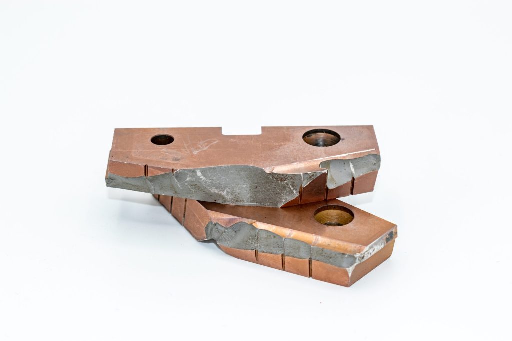

Tool life is often a top priority when working in a high-production environment. To some degree, it does not matter if you have the fastest or the best tool; it is more important to have a tool that fails consistently in the same way, but the question then becomes how do you achieve this? How can you proactively plan for predictable tool failure?
Many factors contribute to failing consistently from the tools themselves to outside factors like coolant, machine maintenance, and material hardness. While it is unrealistic to hit 100% repeatability, it is key to keep as many factors as you can the same from job to job and part to part.
Establishing repeatability makes it easier to prevent catastrophic failure that will damage the workpiece and tooling, which becomes much more expensive than just taking the tool out early even if that is before it is completely worn out. Therefore, cost savings is one of the biggest benefits of consistent tool life. It is better to change an insert out ahead of time instead of pushing it to max life and potentially damaging components of the tool or components of the machine—causing more setup time and more machine downtime.

Aside from these top factors to consider when planning for predictive tool failure, you can also work to baseline your tools. Whenever you are running off a project for the first time, the first couple of tools you are putting into the part needs to be monitored to ensure that speeds and feeds are optimized and that repeatability is established. If it repeats after a couple of tools, that is your baseline; you can reach “x” amount of parts per tool.
Other things to consider are load limiters and part counters. For predictive tool failure in job shops, use load limiters. If one tool is consistently running at 80% load, when the load begins to steadily climb to the upper end, you will know when inserts are dull and need to be changed. Part counters can be integrated into the programs. By establishing a baseline as discussed above, you will know what the tool can do and then program that into the machine. Because the actual program is counting as parts are processed, there is no error like if an operator is counting the parts; the program will stop, and no additional parts can be run unless the tool is changed.
