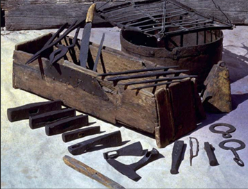

Iron age tool box

Toolboxes and bags go back a long way in human history. Once a tool was found to be useful, it became valuable and was worth keeping. A tool and the skills to use it are closely connected. Mechanical people object strongly to any interference with their tools just as musicians would object to someone tampering with their instruments.

Top: Iron age tool box. Above: Bit Tool Box.

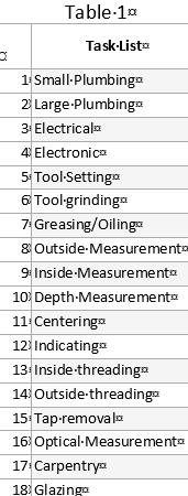

1.    How many different tasks need to be performed? (See Table1)
table 1

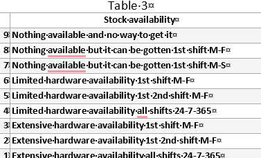

​​​​​​table 3

6.    Stock tools available? Refer to Table 3

Multiply all the answers from 1-8 above and divide by 1000 and check the answer against Table 4.  If the  result is higher than 100, make every effort to correct the problem.
