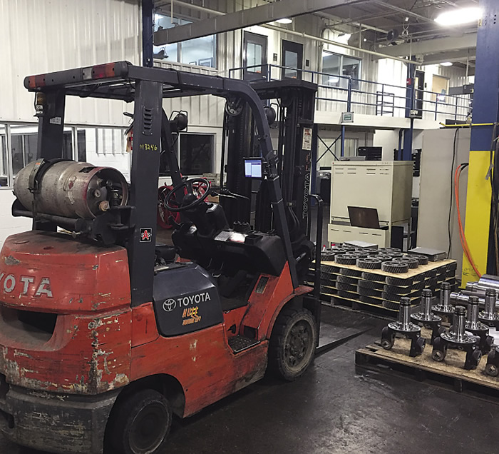

Each ITAMCO forklift is linked to the company’s ERP system through GPS and an application on forklift-mounted tablets. Image courtesy ITAMCO.
Sensors on the forklift ignitions enable ITAMCO to know when they are turned off and when they are running, and the GPS on each vehicle enables the manufacturer to know where a vehicle is and where it is heading, he explained. As soon as a machine operator scans the bar code on a pallet, signifying the completion of the product cycle at that machine, a forklift is on its way to the machine. Forklift-mounted tablets enable the drivers to see the job information, and drivers are notified via their smart devices when they are needed. According to ITAMCO, the communication system is so efficient it will summon the closest forklift to the machine.
