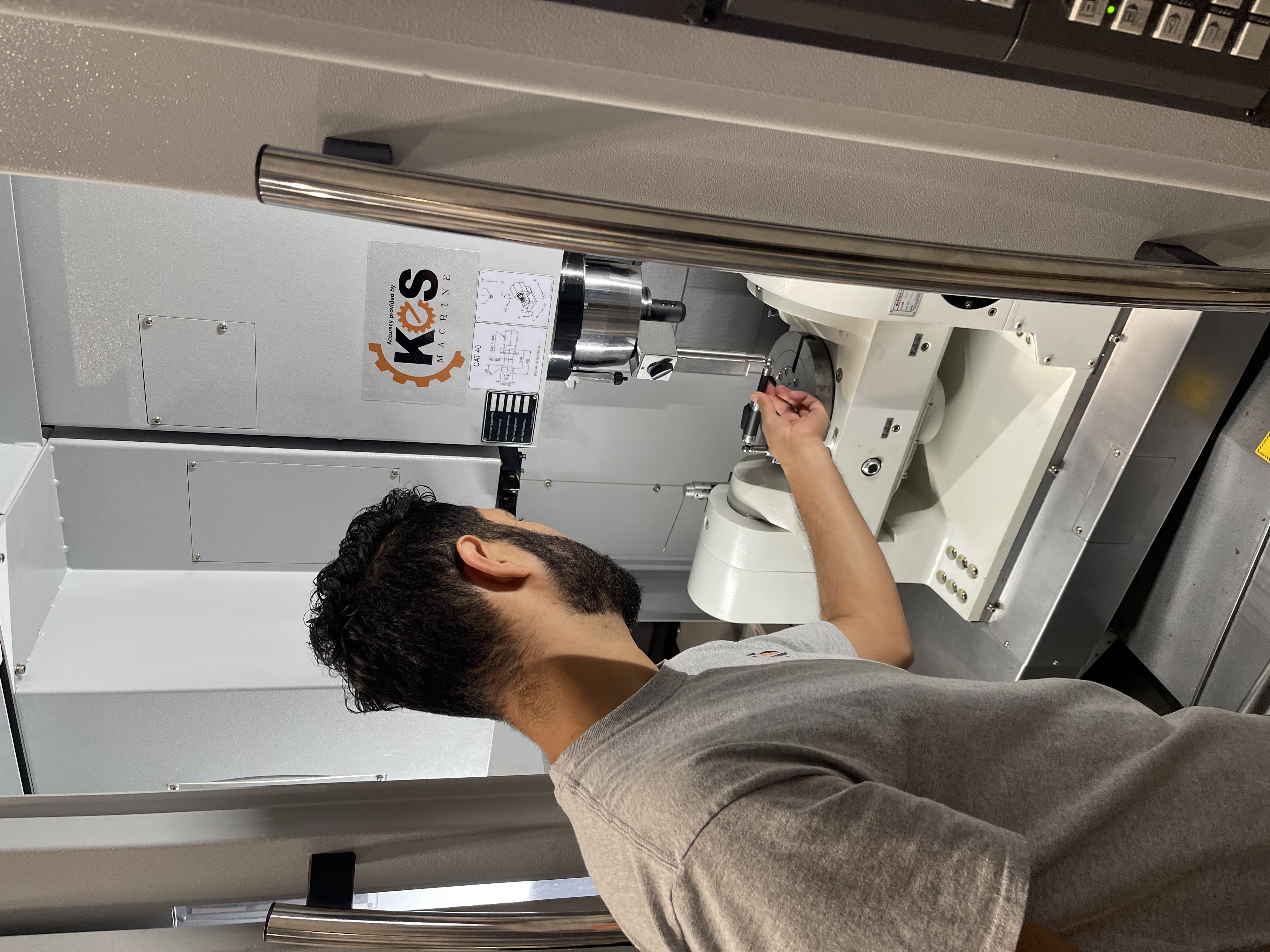

KES QC20 ballbar system.
Setting up the QC20 ballbar system. KES also purchased a Renishaw XL-80 laser system, XR20 rotary calibrator, and off axis rotary software.
