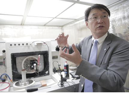

Sangkee Min, University of Wisconsin-Madison College of Engineering assistant professor, with the FANUC ROBONANO α-0iB. Image courtesy University of Wisconsin-Madison.
That prowess is being put to use at the University of Wisconsin-Madison College of Engineering, where it is newly housed in the laboratory of Sangkee Min, an assistant professor of mechanical engineering at the university. The machine is there on a multiple-year loan from FANUC. Officials from FANUC traveled from Japan for a Sept. 11 ribbon-cutting ceremony and open house for the ROBONANO.
Min will use the machine’s capabilities to explore its suitability for manufacturing emerging materials, as well as currently available materials like synthetic sapphire, a shatter-proof alternative to glass for screens on devices such as smartphones. Synthetic sapphire is difficult to manufacture at a large scale because it is brittle and difficult to handle. However, Min has already conducted initial research on synthetic sapphire with a ROBONANO machine in Japan and discovered that the material sometimes is more ductile when handled at the nanoscale level.
