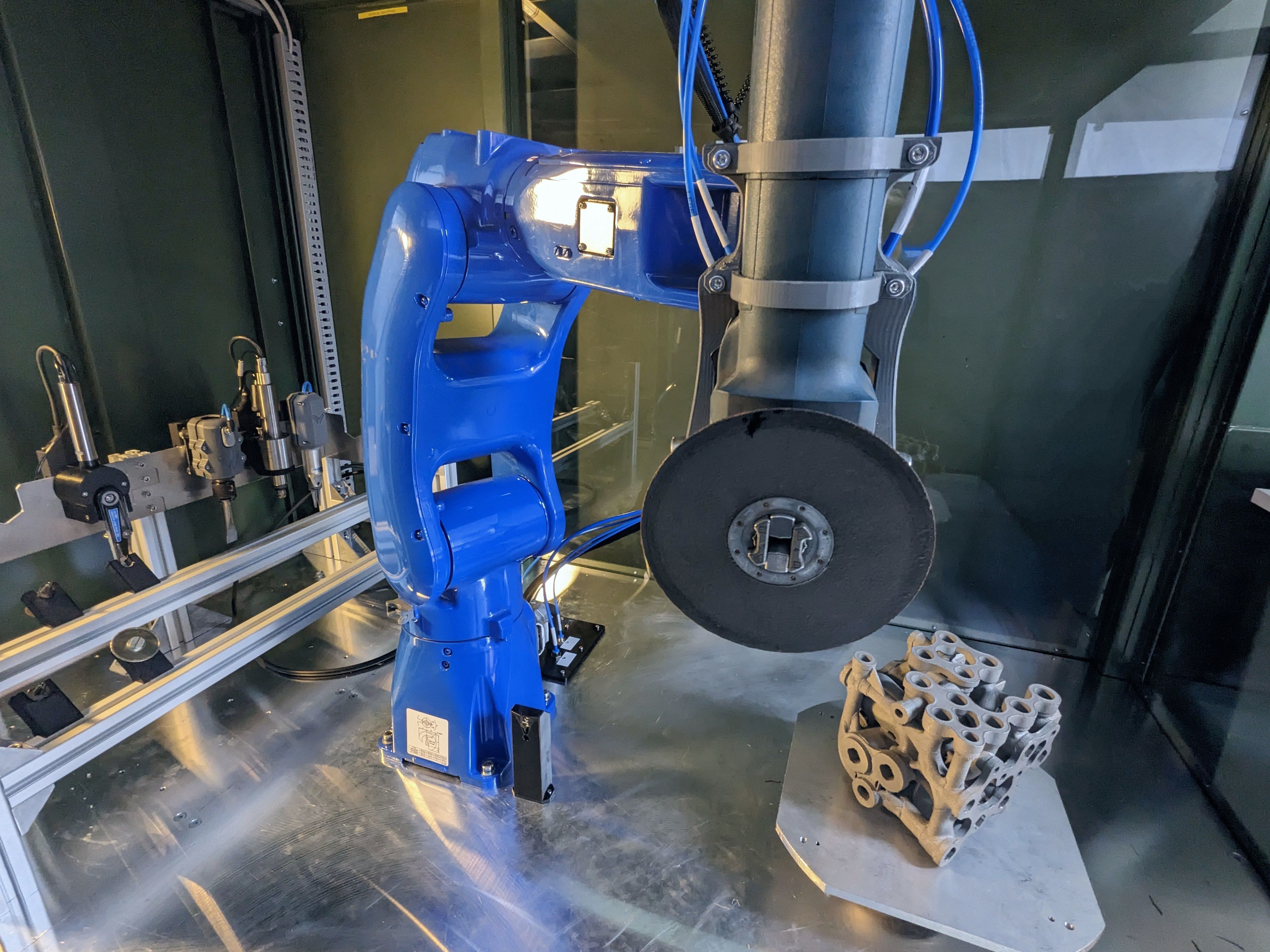

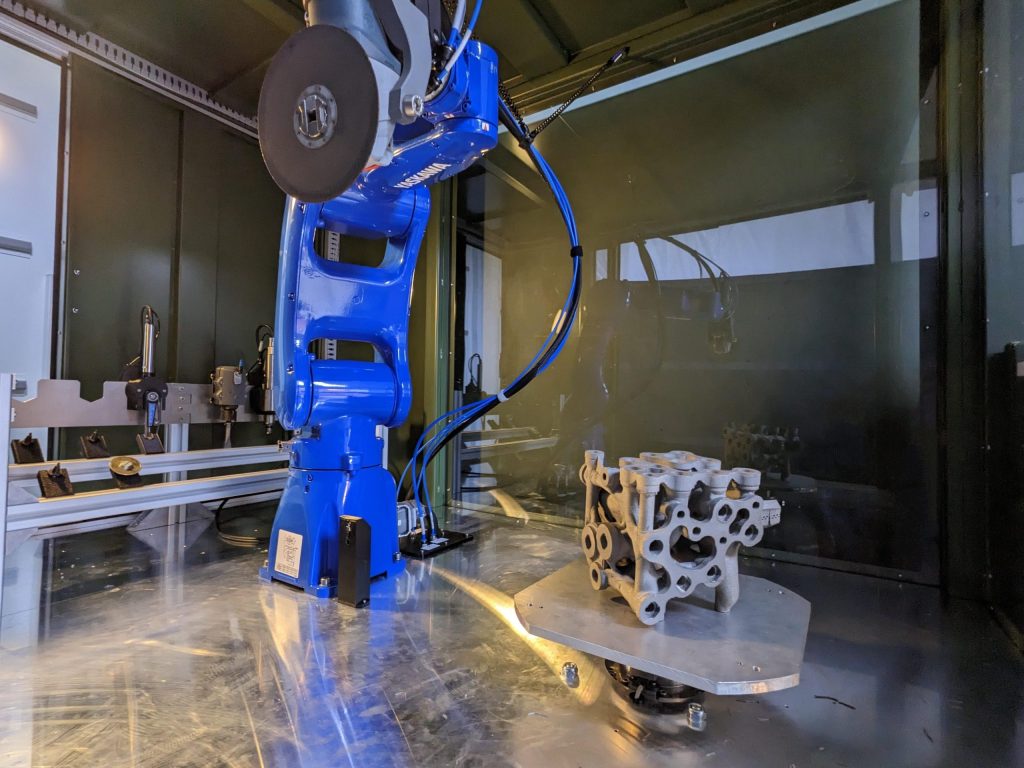

Robots
So, AM needs automation that can adapt to variability, especially for support and witness removal. And this challenge has been solved through the use of sophisticated software and artificial intelligence systems to help generate toolpaths and robot motions without mobilizing an entire systems-engineering team. This then allows for quick iteration as well as automation of small batches.
3D scanning can be used to locate parts instead of high-precision fixtures, which means desktop FDM printers can be used to make plastic fixtures quickly without worrying about accuracy or changes to the design. In addition, force sensors can be used to feel the surface and adapt the machining accordingly, to spend more time on high spots until the final shape is reached, or to polish to a consistent finish
One huge advantage is that any tool can be used for support removal and finishing. If it is already known what tools work well with the materials or the types of supports printed, the same tools can be attached to a robot to automate more confidently. With today’s technology, the steps to add a new custom tool are basically like adding a new type of endmill to a CNC machine and do not require a system integrator that charges by the hour.
Robots are emerging as a superior solution compared with CNC machines for the automated removal of supports from metal AM parts due to their speed, efficiency, flexibility, accuracy, repeatability, safety, cost-effectiveness, and sustainability. The use of robots in this process not only results in a better-finished product, but also provides a safer, more sustainable, and more cost-effective end-to-end manufacturing process.
