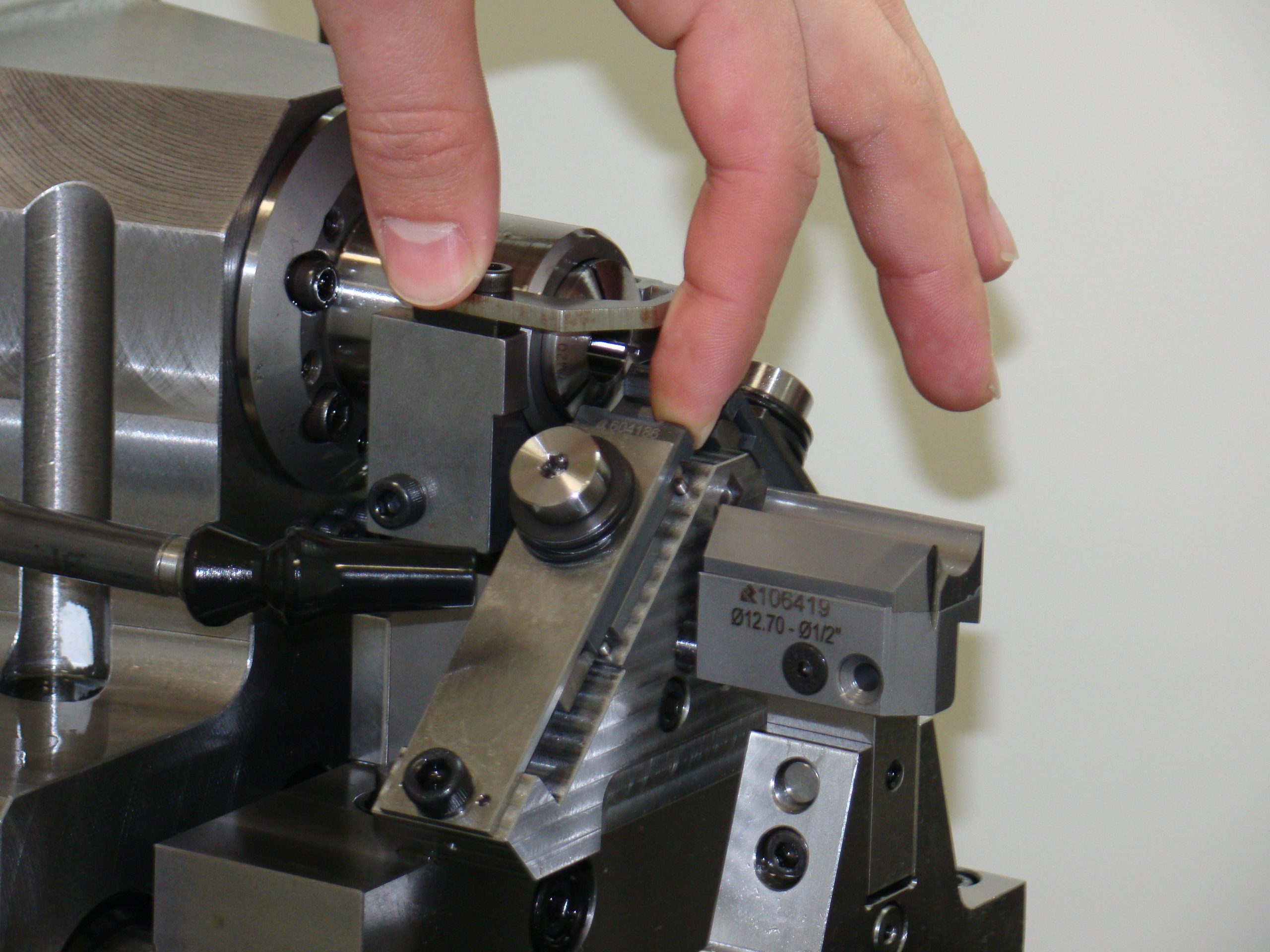

SmartGuide shank-guidance system is set up at Rollomatic Inc.'s open house in Mundelein, Ill.

In addition, the event showcased a system for V-block shank guidance with a top clamp that boosts productivity by simplifying the process and reducing setup time by 5 to 10 minutes. Rollomatic reports that its SmartGuide ensures a maximum tool runout within 3µm, reduces shank-guide tooling costs by 70 percent and can be retrofitted onto existing grinders.
