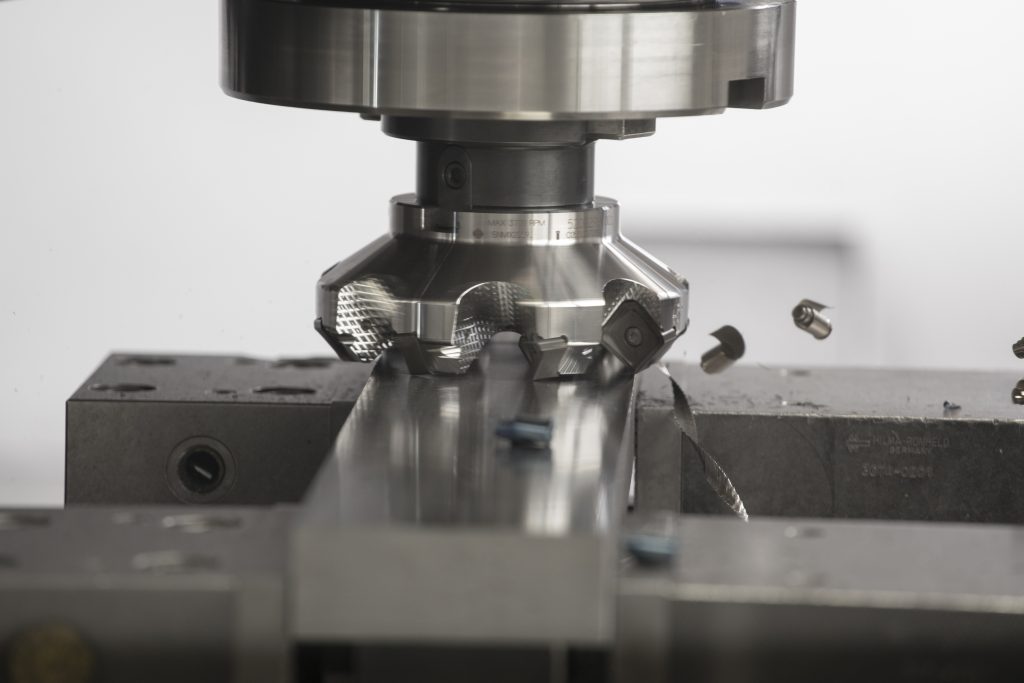

Almost every machine shop uses facemills for roughing, semifinishing and finishing, but many of these shops miss out on increased material-removal rates because they run yesterday’s tooling on today’s machine tools. The larger spindle tapers and higher horsepower ratings, feeds and speeds of modern machines need to run with the latest in facemilling cutter and insert technology to maximize a machine’s facemilling potential and thus significantly speed up production, increase efficiency and reduce cost per part, especially on larger workpieces.
The latest facemilling cutters incorporate a new generation of multiple-sided, multiple-edged insert options – inserts with free cutting capability – that help optimize current machine tool performance. These insert geometries increase tool life, reduce cutting forces and produce chips with the open formation that reduces cutting edge stress.
Shops gain the ability to facemill with less force and take full advantage of their machine tool spindles' capabilities through increased cutting widths, depths and/or feed rates. The key to these performance advantages lies in using the right lead and rake angles. When cutting tool supplier Seco Tools developed its latest Double Quattromill 22 and 14 facemilling cutters, for example, it opted for dual lead angles of 45° and 68° cutter bodies.
A 45-degree lead angle produces better chip thinning, higher feed rates and more bidirectional cutting forces.
A 45° lead angle on the Double Quattromill 22 produces better chip thinning, higher feed rates and more bidirectional cutting forces.
These dual lead angles accommodate medium to large DOCs and enable shops to choose the cutting force options that best suit their individual workflows. A 45° lead angle on the Double Quattromill 22, for instance, produces better chip thinning, higher feed rates and more bidirectional cutting forces, all attributes that suit situations with unstable or weak fixturing. The 68° lead angle of the Double Quattromill produces higher DOC capabilities within the same inscribed circle diameter. Its chip thinning performance improves on 90° lead angles while it offers greater ability to avoid sidewalls or fixturing than a 45° lead angle.
Cutter geometry largely determines facemill performance. Highly positive geometries produce free and easy cutting, even with double-sided edges. Along with lead angles, axial (GAMP) and radial (GAMF) rake angles influence cutter behavior. The combination of negative axial and radial rake produces strong cutting-edge geometry and high productivity, able to accommodate heavy feed rates, interrupted cuts and other difficult machining procedures – all necessities with large, heavy-duty spindle tapers and rigid fixturing. With the correct choice of insert geometry, however, these same cutters work well with machines that offer lower horsepower levels. Because of these advantages, Seco Tools designed the Double Quattromill 22 and Double Quattromill 14 with negative axial and radial rakes.
Seco Tools offers three choices of insert geometries.
To make the Double Quattromill 22 and Double Quattromill 14 applicable to a broad range of applications, Seco Tools offers three choices of insert geometries.
Insert geometry options further enable shops to specify their facemills and inserts to match their workflows. To make the Double Quattromill 22 and Double Quattromill 14 applicable to a broad range of applications, Seco Tools offers three choices of insert geometries. Double Quattromill 22 includes ME12, M12 and M18 while Double Quattromill 14 uses ME10, M10 and M16. These geometries boast capabilities that lend themselves to working with specific types of machine tools and materials.
ME12 and ME10 provide a sharp edge that creates lower cutting forces than M12, M10, M18 and M16. As a result, ME12 and ME10 work well with lower horsepower levels, and are well suited for sticky materials such as titanium and stainless steel.
M12 and M10 have sharper edges and smaller T lands that create less cutting force than M18 or M16. This reduced force excels at lower spindle horsepower levels, while the M12 and M10 do well with sticky materials, some tool steels and superalloys.
M18 and M16 provide the best edge protection when machining abrasive materials. These geometries are well suited to steels, tool steels and cast irons.
For modern equipment with less horsepower but with strong, efficient performance, Seco Tools designed the Double Quattromill 14 as a smaller cutter for machines that don't develop average chip thickness or run the aggressive feeds of their larger siblings – the overwhelming percentage of the modern machines in current use, many of which can't make full use of bigger facemills such as the Double Quattromill 22.
Cutting edges only function properly when inserts fit and lock securely into cutter bodies, especially when it comes to multiple double-sided insert cutting edges. With typical wedge clamping systems, inserts can move or shift under the substantial forces of aggressive feed rates and cutting depths. Conversely, the center locking screws of Seco’s Double Quattromill cutters ensure mounting security for both fixed-pocket and cassette-style bodies.
With performance that matches today's equipment and a range of options relevant to the industries that will use these facemills, the Double Quattromill 22 and Double Quattromill 14 optimize the face milling performance of any spindle.
