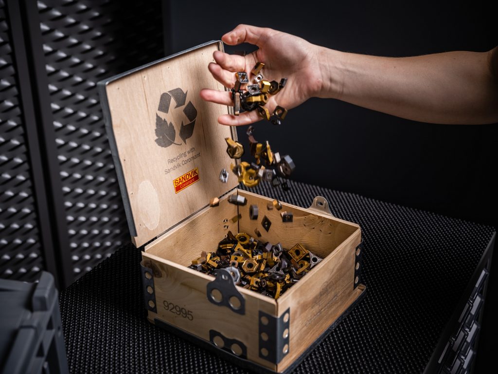

When crafting a sustainability strategy, one of the most important elements an industrial company must review is its waste. The circular economy doesn’t only offer environmental benefits. As soon as Sandvik Coromant’s own metal cutting tools lose their effectiveness, as is natural over time, it would be all too easy for customers to toss them away and render them unusable. However, the materials used to make those tools remain valuable.
About 95 percent of a used carbide insert can be recycled. Of this carbide, tungsten makes up around 75 percent. Making new tools from recycled solid carbide requires 70 percent less energy than producing with virgin raw materials. Production is also more sustainable, and using recycled materials emits 40 percent less carbon dioxide compared with starting from scratch.
Circular adoption addresses both global sustainability challenges while taking care of an issue that few customers desire to manage — waste.
Overseeing the entire life cycle of a product, like the tools manufactured and sold by Sandvik Coromant, gives businesses greater control of their assets. This control means a company can effectively review its costs while also helping its customers who will benefit from selling used products, creating a supplier relationship that does not cease once the initial purchase is complete.
So how does it work?
As part of Sandvik Coromant’s own global recycling process, used carbide tools are collected from customers and sent to the Wolfram Bergbau and Hütten recycling plant, located in Austria. There, recycling managers complete an X-ray fluorescence analysis using a scanning system, which determines the make-up of the received tools. After an initial crushing, the tools form a carbide powder. This powder undergoes chemical purification to retrieve materials that have the same properties as virgin tungsten.
Additional elements in the cemented carbide are also managed sustainably. For example, cobalt retrieved from the tools is sent to a third party for recycling. Carbide tools from all manufacturers are accepted into Sandvik Coromant’s recycling program, regardless of size, industry or location.
