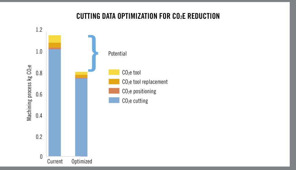

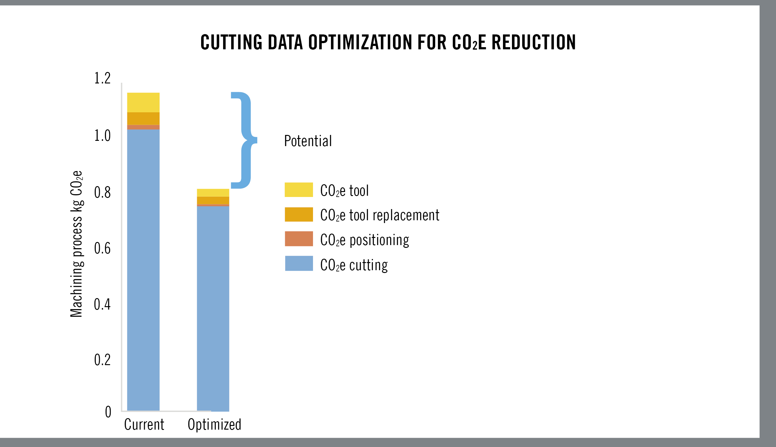

HQ_ILL_Cutting Data Optimization For CO2e ReductionSustainability is one of the strategic focus areas for Seco, and the company has ambitious targets and plans for how to contribute to a better climate in accordance with the UN Global Goals. The company uses calculation methods to report greenhouse gas emissions from its own production. As the next step, Seco is developing systems that will enable its customers to optimize use of Seco products and thereby reducing their climate impact.
“When companies analyze their climate impact, they generally base this on traditional life-cycle analyzes of their own manufacturing and products,” said Ted Forslund, global sustainability coordinator at Seco. “However, 70% of the climate impact of our tools occurs in the user phase. Significant gains can be achieved by helping our customers optimize the use of our tools.”
Seco and its R&D department are now developing data models that can be used to calculate customers’ carbon footprint in the user phase. The model takes the entire life cycle of a tool into account, including energy consumption and the use of coolant in the customers’ production processes. This in turn helps customers to optimize their processes and reduce their climate impact. “By making the right choices, using the correct cutting data and avoiding suboptimizations when producing individual parts, customers are able to reduce their carbon footprint by at least 20%. The idea is to find the optimal way to produce a part by changing different parameters,” said Sören Hägglund, PhD and R&D expert cutting data at Seco.
To help with this, the R&D department at Seco has developed software that can be used to simulate various production processes and try out different alternatives for producing an item, such as choice of processing method, machine, strategy and tool.
“For example, it is possible to see if you are using a machine or tool to its full potential during a particular production process. If you can see that the full potential of a machine or tool is not being used, it might be worth selecting other options in order to minimize the carbon footprint,” said Daniel Johansson, PhD and senior R&D professional at Seco.
The advantage of this is that customers can easily see how to reduce their carbon footprint, which is something many customers have asked for, according to Daniel Johansson. “There is a lot of demand for sustainable manufacturing, but this solution may not have occurred to many in the machining industry,” he said. “What is unique about our solution is that in addition to being able to see our own products, we can also include customers’ processes and offer them the opportunity to minimize the carbon footprint of their production. To use a term borrowed from the automotive industry, we offer a so-called Eco button.”
