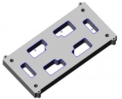

ESPRIT is a feature-based CAM system that automatically recognizes the machinable features that are specific to wire machining. Choices include die (pocket), punch (boss), hole, open profile, and even turning profile features for wire machines equipped with a rotary table. An emphasis is placed on fast and easy creation of machinable features for wire EDM. Detailed properties about XY and UV profiles, workpiece height, tapers and corner styles are associated with the EDM features so that, regardless of the type or number of operations applied to the feature, the integrity of the underlying data remains the same. When EDM properties are embedded in the feature, the entire programming process is streamlined because most of the data needed for programming is coming from a single, reliable source.

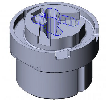

ESPRIT Feature Recognition only recognizes walls that can be cut with wire EDM and ignores the rest. All images courtesy of DP Technology
ESPRIT automatically recognizes all die openings in a plate with a single click.

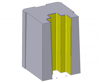

When only certain walls need machining, individual solid faces are easily selected for feature recognition.

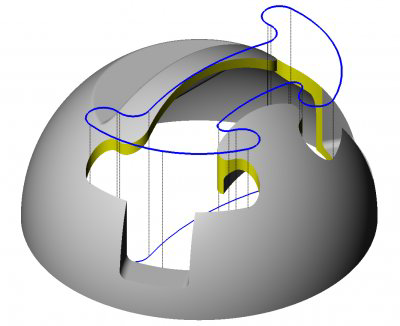

ESPRIT detects maximum and minimum plane heights and accurate profiles, even on curved walls.

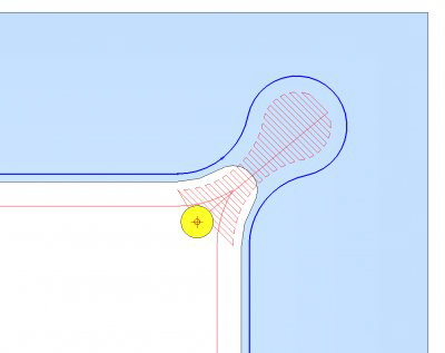

Let’s take the case of a die profile that is relatively uncomplicated, except for small openings along the edges. If the wire for the rough cut is too big to fit into the small openings, the profile can be contoured first in G40 mode with look-ahead to prevent the wire from entering the small openings. Once the slug is dropped, a no-core pocketing operation can follow to burn away only the small amount of material that remains. Then the same contouring operation will skim the entire profile because look-ahead will now recognize that the openings have been cleared of material.
Combine contouring on large profiles with no-core pocketing on small openings to efficiently cut awkward 2-axis profiles.

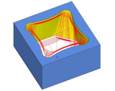

ESPRIT’s 4-axis pocketing takes this concept a step further. Built-in options will automatically identify and isolate the largest area inside a complex cavity that can accommodate a slug drop. This “core” area is removed with a simple 2-axis contouring operation. Then, 4-axis no-core pocketing wire path is applied to remove only the material that remains.
Four-axis pocketing detects the largest area for a slug drop, then applies no-core pocketing only to the remaining material for faster machining of complex cavities.

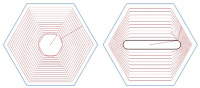

Sometimes, a big hole or a groove is premachined inside a pocket cavity to remove as much material as possible and, at the same time, release the stress within the material. Other times, a model has a cast pocket cavity and the inside profile could be of any reasonable shape. Pocketing passes must recognize and adapt to the shape of an internal cavity to avoid cutting air.
ESPRIT’s no-core pocketing offers the option of a constant offset around a predrilled hole or a smooth transition between the shape of an internal cavity and an outer profile.

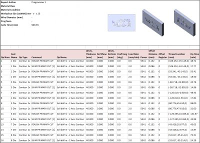

It is also important to have an accurate estimate of cut time for each part program. Reliable estimates are vital to scheduling and planning unattended operation for the available hours. When setting up a job to run overnight, an accurate time estimate will ensure the job will be done in the morning. Programmers can view cycle times in an ESPRIT document or quickly generate a complete and accurate report of all operation cycle times and total cycle time, plus all thread locations, wire and workpiece data, and any specific setup instructions. Automating the wire EDM process can help a shop succeed by reducing production costs and improving responsiveness.
A detailed report gives an accurate estimate of cut time for unattended machining.

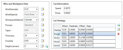

ESPRIT provides a universal data reader that gives users access to manufacturer-recommended cut data for their make and model of EDM. The ESPRIT EDM Expert System is an integrated component of ESPRIT Wire EDM, accessed from any EDM operation page. The programmer chooses the wire size and workpiece data to display optimal cutting strategies. Once a strategy is chosen, the manufacturer-recommended values are loaded into the operation with a single click.
The ESPRIT EDM Expert System makes it easy to access and customize manufacturer-recommended EDM cut data.
Using the databases provided by ESPRIT as a baseline, wire EDM users have the option to modify the data while they work to more finely tune the way they cut parts and create customized cut strategies. Changes to the database can be saved to a new file or the current database can be overwritten. The EDM cut data is stored in external XML files that are simple to use and easy to update. However, instead of exiting ESPRIT and working with XML code directly, the Expert System lets programmers edit their database directly within the ESPRIT work environment. This simplified method of editing data in a familiar environment lets EDM programmers test and fine-tune cut strategies quickly while they work, without the need to learn XML coding.
