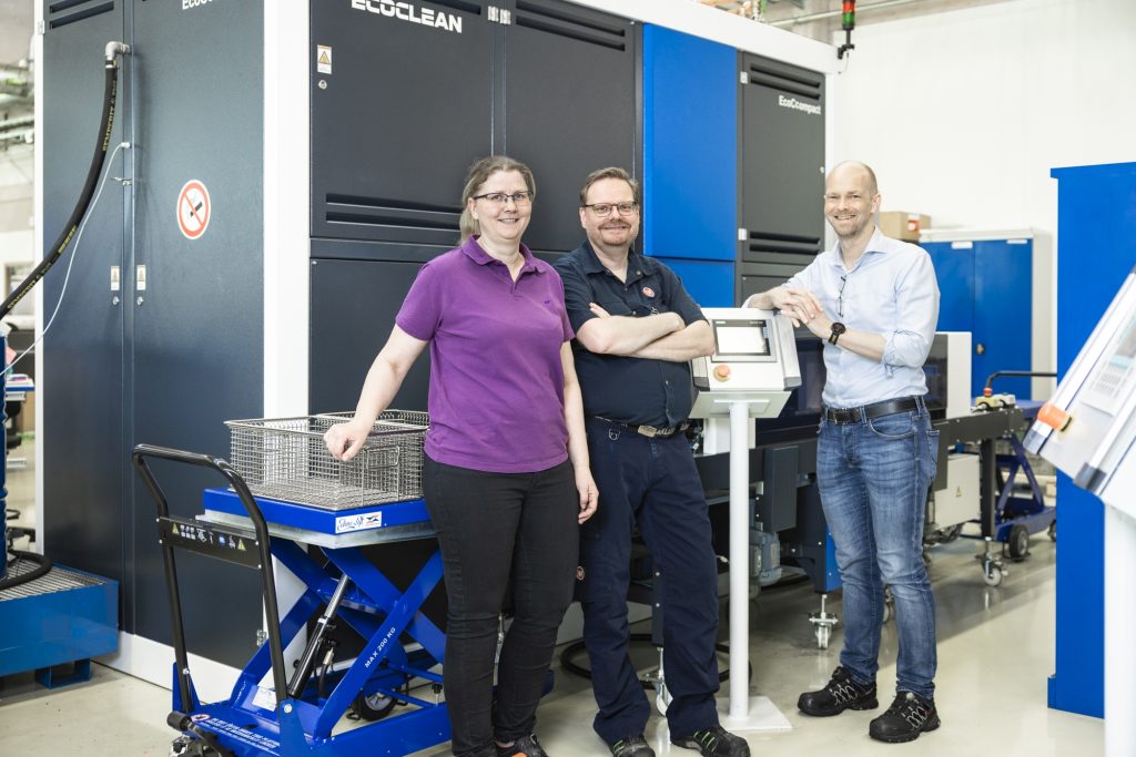

To be optimally prepared for future cleanliness requirements, a Swedish manufacturer replaced one of its existing solvent-cleaning systems. They chose an Ecoclean EcoCcompact fitted with Ultrasonics PLUS, to mention only one of the system's features.

The system concept as well as numerous features available as standard options such as the three flood tanks for the Wash. Rinse/Rinse or Preserve process steps were major decision criteria in favor of the EcoCcompact.

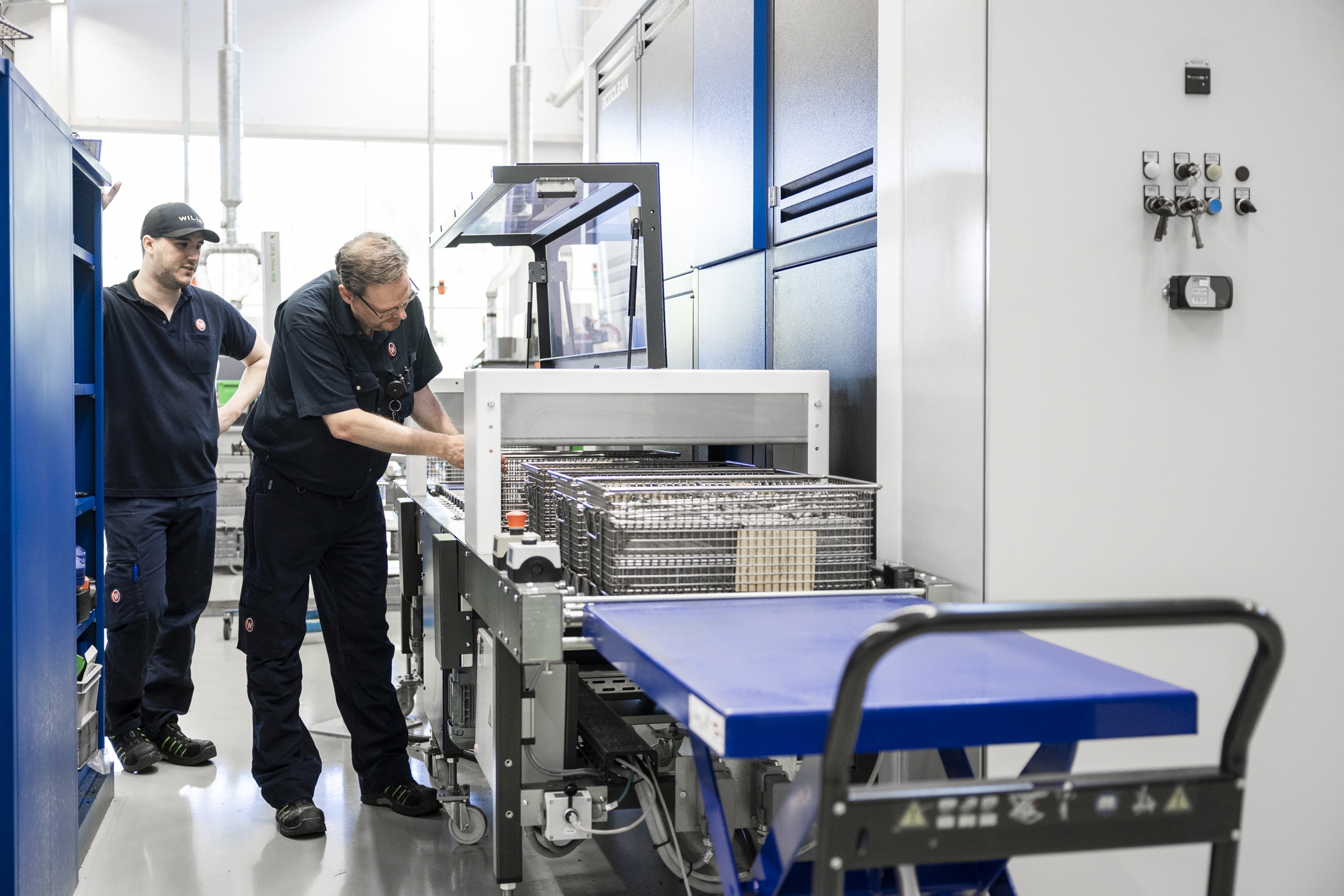

Depending on the type, parts are supplied in bulk or arranged in part carriers and treated by one of the ten programs stored in the machine control system and which are currently still selected manually. For interfacing with the company's MRP, the machine is equipped with a future-oriented scanner system with integrated software.

We have been using the new EcoCcompact since February 2022 and are achieving cleaning results that will surely be meeting our customers' future demands," said Hultkvist.
