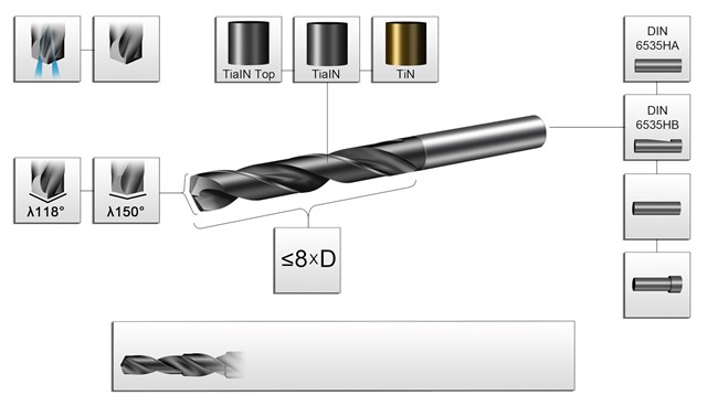

 With Sandvik Coromant’s Tailor Made software platform, customers can go online and specify customised tool parameters, as shown here with the CoroDrill® 460.
 With Sandvik Coromant’s Tailor Made software platform, customers can go online and specify tool parameters, as shown here with the CoroDrill 460.

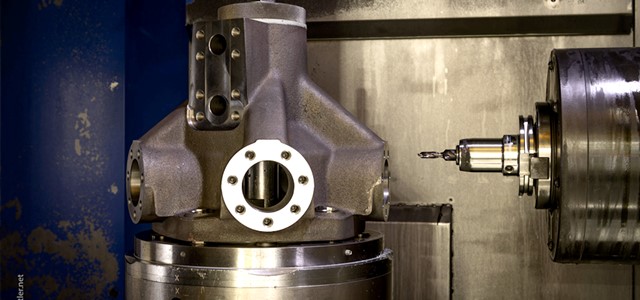

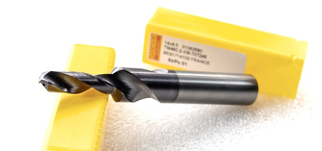

In this instance, Kawasaki Precision Machinery sought to speed up one of its drilling processes at its factory in Plymouth, UK. It wanted a better way to drill holes for the bolts in one of its cast-iron Staffa motor cases. Kawasaki was using two separate drill bits — one for the hole itself and one for the countersink — because the standardized-solution step drill wasn’t suitable for both jobs. So, it turned to Sandvik Coromant and Tailor Made.Within just a few minutes, Kawasaki Precision Machinery was able to log on and enter its customised parameters into the platform. It used its own CAD software to make the necessary tweaks before placing the order, even printing a 3D prototype of the tool. The result is a customized drill that reduced the cycle time normally taken to source a new tool by more than 10%. In fact, the total lead time from design to implementation of the new drill bit was only aound five weeks.
Significantly, the customer’s entire manufacturing process can now be achieved with just one tool, rather than two. A productivity analysis has also found that the new tool has produced instant results. The cycle time for each motor case has been reduced by two-and-a-half minutes, which translates into saving £4 (4.6 euros) per component. Given that Kawasaki produces 42 of its Staffa motor cases every day, these advantages add up.
