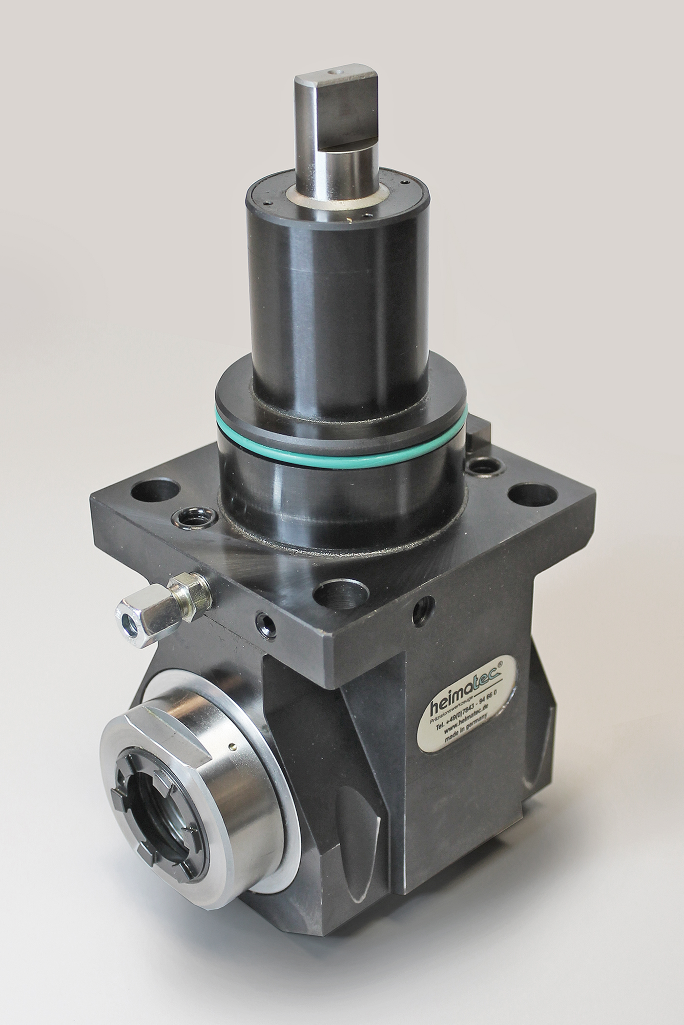

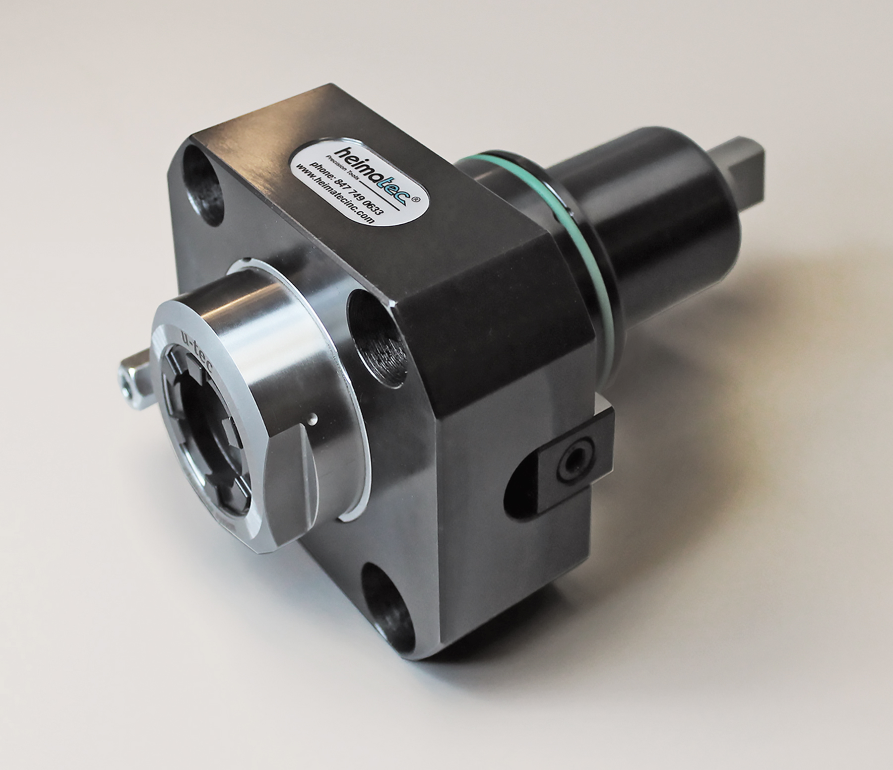

Shown here is a standard BMT cross working tool.
Live tooling, as a component on a lathe, is specifically manipulated by the CNC to perform various milling, drilling and other operations while the workpiece is being held in position by the main or sub-spindle.
These components, whether BMT or VDI, are also called driven tools, as opposed to static tools, that are used during turning operations. All live and static tools are built per the machine tool builder’s specifications for each of the various models they produce. A key to running a successful job shop or production department is to partner with a supplier who can meet the tooling needs for all or most of the machines on your floor.
Most often, live tooling is offered in standard straight and 90-degree angle head configurations with a wide range of tool output clamping systems, including ER collet chuck, arbor, Weldon, Capto, whistle notch, hydraulic, HSK, CAT, ABS, and a variety of custom or proprietary systems developed by the many suppliers to the industry.

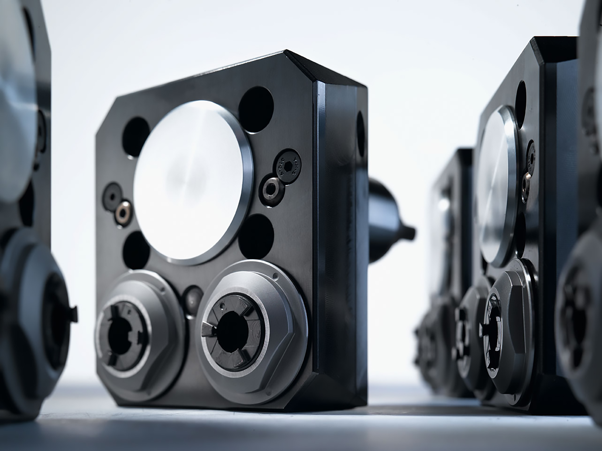

 2.	Multi-spindle tool brings improved cutting capacity to your lathe.
Top: Shown here is a standard BMT cross-working tool.  Above: Multi-spindle tool brings the improved cutting capacity to your lathe.

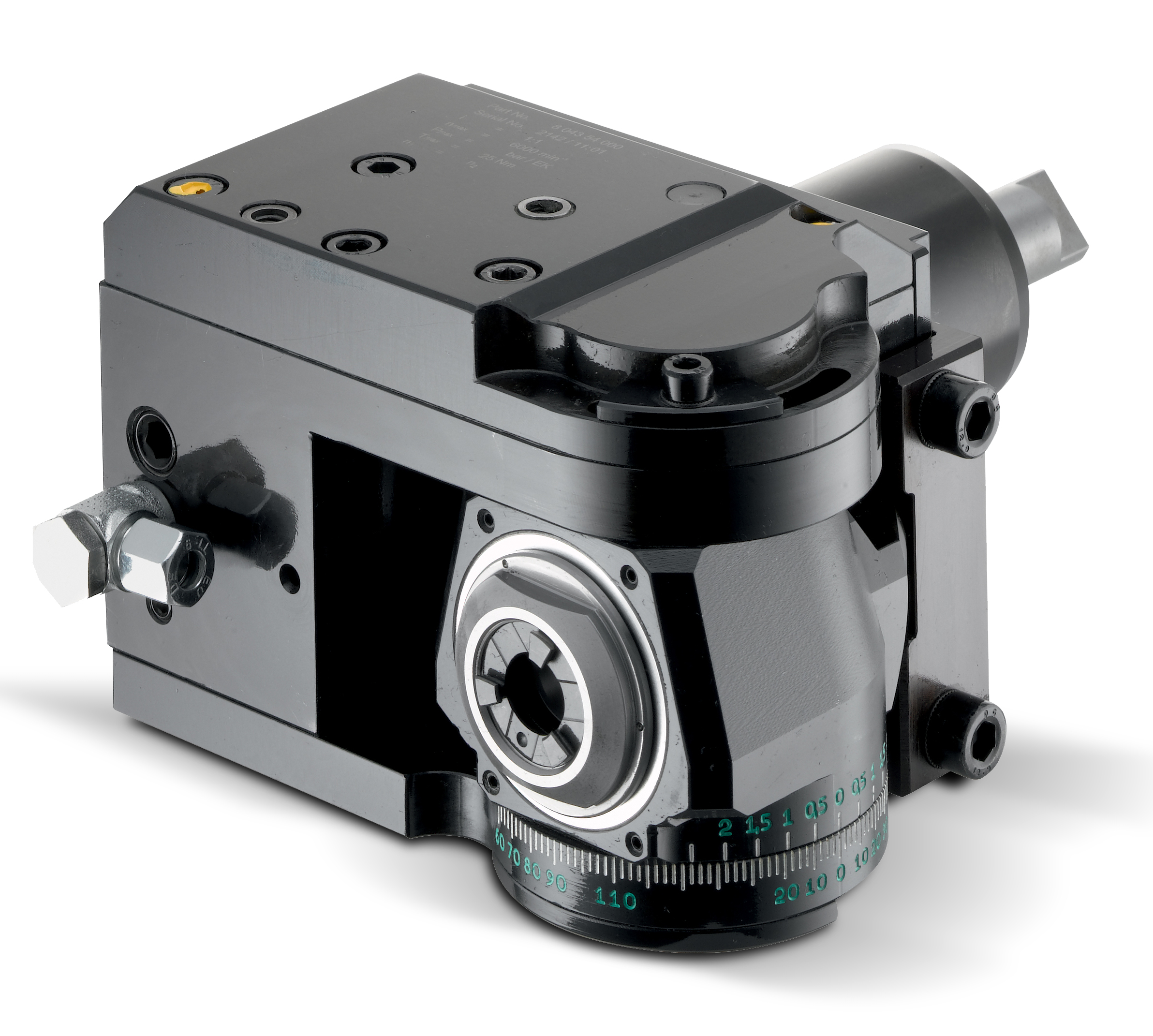

3.	Universal style adjustable tool might be the ideal solution for families of parts.

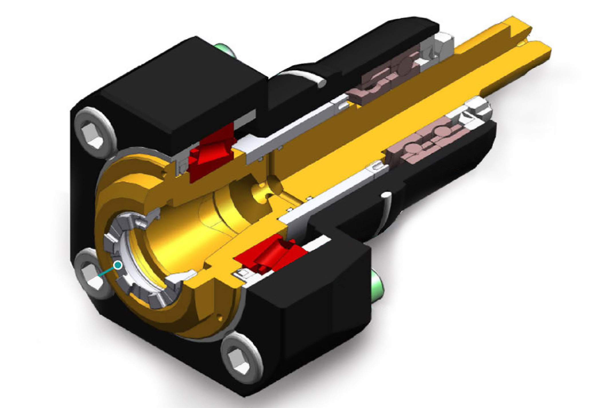

Bearing construction and the resulting spindle concentricity drive the life of any tool. You might find that just a 10-15% greater investment in a better design can yield both longer-lasting cutters and consistently superior finish on your products.  Of course, the stability and rigidity of the machine tool are always critical factors.  Bevel and spur gears that are hardened, ground and lapped in sets are best for smooth transition and maximum torque output.
Taper roller bearings are consistently superior to spindle bearings in live tool milling applications, so look for a combination system to get the highest rigidity possible.  Also, look for an internal vs. external collet nut, so the cutting tool seats more deeply in the tool, as superior performance will result.

It’s possible that a live tool with a built-in speed increaser, often called a speed multiplier, would be helpful. Would it be beneficial to move secondary operations to your lathe?  Gear hobbing can be accomplished in this manner, as can producing squares or flats, through the use of polygon machining.

If standard ER tooling is suitable for the work, there are many good suppliers. It is important though, to pay close attention to the construction aspects noted above. For a quick-change or changeable adapter system, there are fewer suppliers in the market, so seek them out and be sure they can supply the product styles you need for all your lathe brands.

Internal clamping nut seats the cutting tool closer to the bearings.
