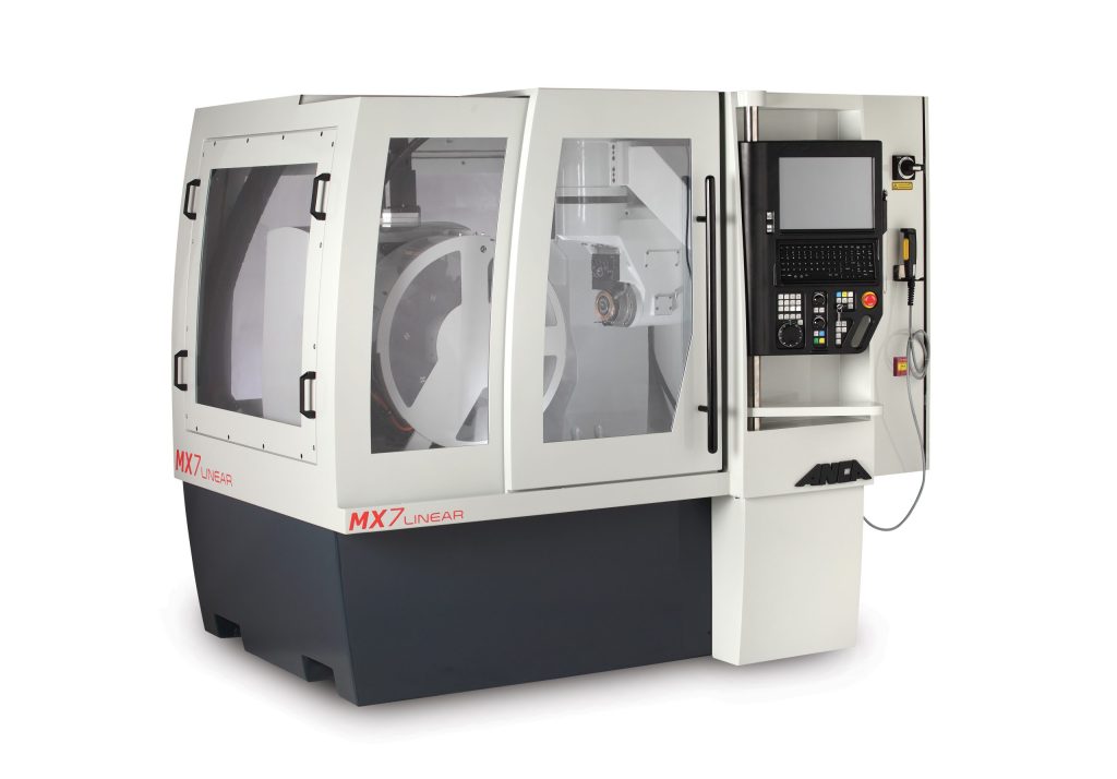

After drafting a shop-floor blueprint for his new business, Bunting invested in a range of ANCA grinders and software. The company purchased two MX7 Linear CNC tool grinders, an FX7 grinder for fast processing, and an EDGe grinder for PCD tool manufacture, as well as other equipment. The company uses the MX7s primarily for automotive tooling as Bunting said they work well when grinding tools with larger diameters of 20, 25 and 32. Pocket grinding for PCD cutting tools is also done on this model. According to Bunting, the MX7 has a lot of horsepower that grinds tools in a very stable way. He noted that the company uses the FX for high volume carbide tooling because it is an extremely rigid, thermally dynamic, and stable machine that the company relies on to grind highly repeatable cutting tools at higher speeds.
On the MX7, Bunting utilizes an ANCA spindle speeder that allows the company to achieve higher RPMs. He said ANCA adjusted the software to provide a better stable pocket and more accurate pockets in the grinding process.
