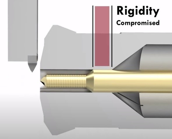

When threading using a traditional ‘single-point’ method on a Swiss machine, or any lathe for that matter, it requires several passes with the tool to achieve full depth of the thread form. This tends to not be too much of a concern on larger diameter screws that use 60 degree included thread forms as the metal removal rate is low and workpiece deflection is minimal. Therefore, the tool pressure required to cut these kinds of threads is relatively low as well.
However, due to the sliding headstock and guidebushing arrangement of this equipment and the features or requirements of the workpiece being machined, this can lend opportunity for the workpiece to ‘fall out’ of the guidebushing as it is passed back and forth through the threading tool resulting in deflection and loss of rigidity. These phenomena become more prevalent when the thread major diameter is smaller than stock diameter. Support provided by the guidebushing is ineffective. Then consider some of the metal removal required to make more aggressive ‘buttress’ style threads such as those commonly found on orthopedic and trauma repair surgical implant designed to affix bone, single point threading becomes a lesser means to get the job done in a cost effective manner. Some of these deep threads can require as much as 40 to 50 passes to complete, depending on thread features.

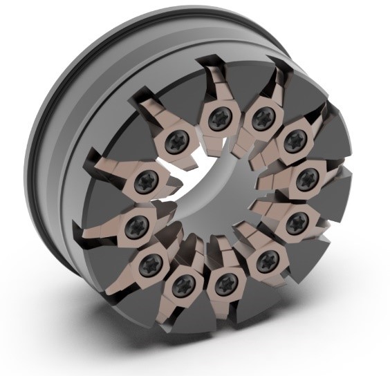

Here’s where thread whirling can be applied to increase the production capabilities of this kind of thread. To perform thread whirling work requires four components: a CNC Swiss/Sliding headstock lathe, a dedicated live tool ‘whirling attachment’ engineered specifically for this process, a cutter ring and body, and the actual carbide cutting tools with the requisite form precision ground into them. These tooling components work in concert to ‘whirl’ bar stock from stock diameter to a finished standard or custom thread form in a single pass.
The cutting action is a milling process similar to inner-diameter thread milling but on the outer-diameter of the workpiece. This gives unprecedented control over finish quality and speed by ensuring the material stays rigid within the guidebushing but also through modulating the chip load per tooth and C-axis RPM. Higher metal removal rates and increased finishes can be achieved through employing as many cutters in the cutter body as possible. When paired with high pressure coolant capability commonly found on most current machines, the cutting zone can be kept clear and free of swarf. As a result, high speeds are attainable resulting in burr-free finished threads in a single pass.

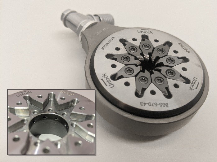

An alternative is to bring the insert flight circle closer to the workpiece. For a wide selection of commercially available whirling attachments either from machine tool builder OEMs or on the aftermarket, there are now cutter rings with built-in positive shifts in the insert flight circle positioning. For example, lets state a lathe’s live whirling tool positioning has a 15mm distance from the standard guidebushing to the centerline of the carbide insert. The job requires whirling a 2.5mm major diameter, double lead buttress style thread form in 6AL-4V titanium. The shop has small diameter bar stock to produce these threads. While this is the perfect type of thread for whirling, the diameter requires us to lend special care in controlling the vibration that can occur from cutting 2 leads at the same time from the stock diameter. Here is where a shifted ring that advances the insert flight circle closer to the standard length guidebushing to make up some of that distance. A simple Y-shift correction is made to re-center the insert form on the cutting position of the bar stock. Often it is possible to achieve success using a shifted ring without an extended nose guidebushing.

New products  are available including a coolant-thru jet equipped with whirling attachments and cutter rings developed by PCM Willen SA of Switzerland for its line of whirling attachments. This streamlined setup can ensure reliable coolant delivery that pushes the cutting fluid to the cutting zone helping evacuate chips and maintaining lubricity and tool life extending cooling. Coolant and high-pressure oil are pushed through the cutter ring itself and into coolant channels internal to the cutter ring.  The high-pressure oil jets are angled just slightly and calibrated to work with the insert’s gage length, eliminating any question of whether lubricity and optimal cooling is achieved. The added benefit of the new coolant ring design is they also can affix from the back side of the whirling attachment via small spring detent locking screws, which can save time when the time comes to index the carbide to a fresh edge. Paired with high-pressure quick release lines swapping over inserts is easier than ever.
