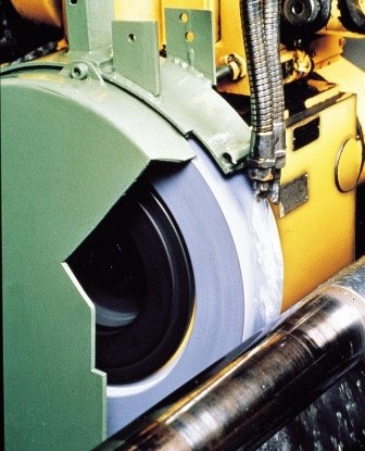

When considering upgrading a cylindrical grinding process from a conventional vitrified aluminum oxide or ceramic Upgrading VitcBN wheels can increase productivity, part quality, and lower costs.wheel to Vitrified cBN (VitcBN), there are 5 main reasons that can help justify the use of cBN over conventional abrasive grains.
1. Cycle times
Since cBN has a higher hardness factor and can stay sharper for longer periods of time, it can be pushed harder and cut faster and with a reduced frequency of re-dress.
2. Super hard materials
With some hard to grind materials such as M4, cBN makes more sense than conventional grains because sometimes the hardness of the alloy is close to the hardness of the conventional grinding wheel, which can glaze or damage the wheel.
3. Grinding stock
Having a high volume of material to remove may warrant using VitcBN grinding wheels.
4. Reduce costs
The VitcBN wheel reduces the amount of dressing required, and the abrasive layer needed (usually from 3mm to 9mm radius) to grind big batches. This can translate into lower overall operation costs.
5. Thermal stability
The thermal conductivity of the cBN grain is greater than aluminum oxide or ceramic grain, which helps dissipate heat.

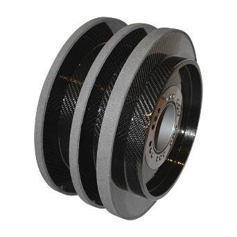

3. Horsepower: VitcBN wheels have a steel core that makes them heavier. The motor will require enough horsepower to spin the wheel, and maintain grinding speeds. Carbon fiber has been used as a core material to lower weight, but costs more.

Machine Rigidity
Since cBN is harder than aluminum oxide or ceramic grain, the grinding machine needs to be rigid enough to withstand the grinding forces. In addition to having tight spindles, it is also necessary to have close fitting slides.
Safety
Machine guards: When running VitcBN at higher speeds, it’s important to have a guard to protect the operator.

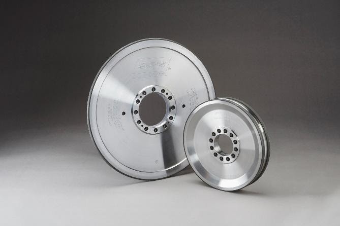

Grinding wheel considerations
If the cylindrical grinding machine cannot spin the wheel fast enough, the VitcBN specification will need to be modified for slower speeds.
If the spindle cannot take the weight of the VitcBN wheel, a smaller wheel will need to be designed, as long as the machine and process can accept that. It may be possible to change the wheel core to a lighter material.
