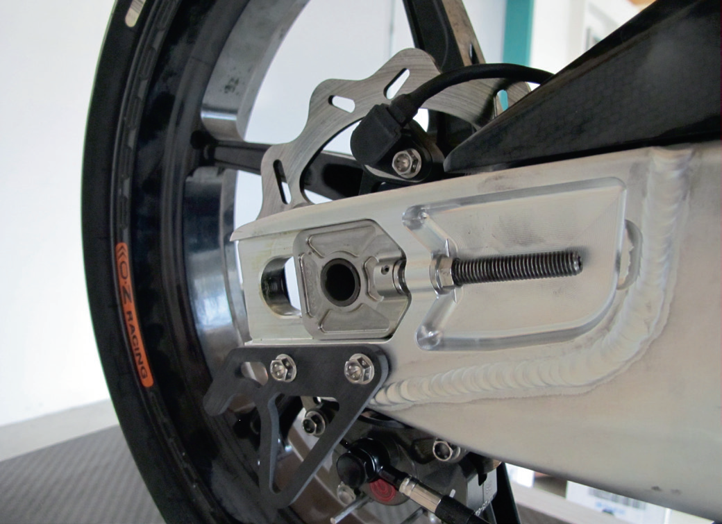

The rear axle of the Moto3 motorcycle; titanium screws and turnbuckles. Photos courtesy of KAISER Precision Tooling
According to Roger Sutter, engineer at the Swiss racing motorcycle manufacturer Suter Racing, the challenge is in building a motorcycle with the right rigidity at a low weight. “For us, every gram counts,” he says. To manage this balancing act, the use of titanium has been inevitable for motorcycle manufacturers. “The strength and light weight is perfect for us,” says Sutter. However, the light metal is also hard to cut. “It is a real challenge to find the optimum components for working with titanium,” he adds.

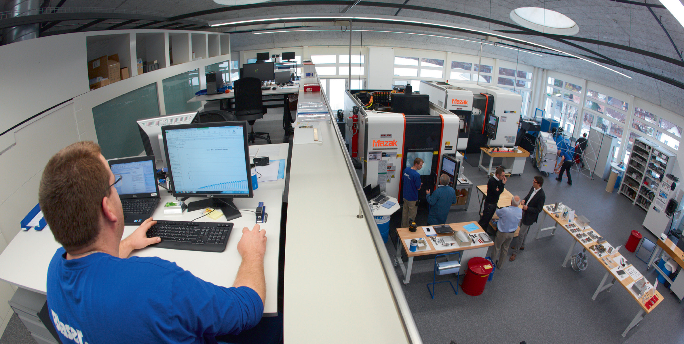

Unique Technology Center
To illustrate the importance of this necessary evil in the cutting process, Blaser has set up a Technology Center at its main site in Hasle-Rüegsau, which is unique in this sector. At the 3,200-sq.-ft. site, customer cutting processes are optimized and their own products are tested.

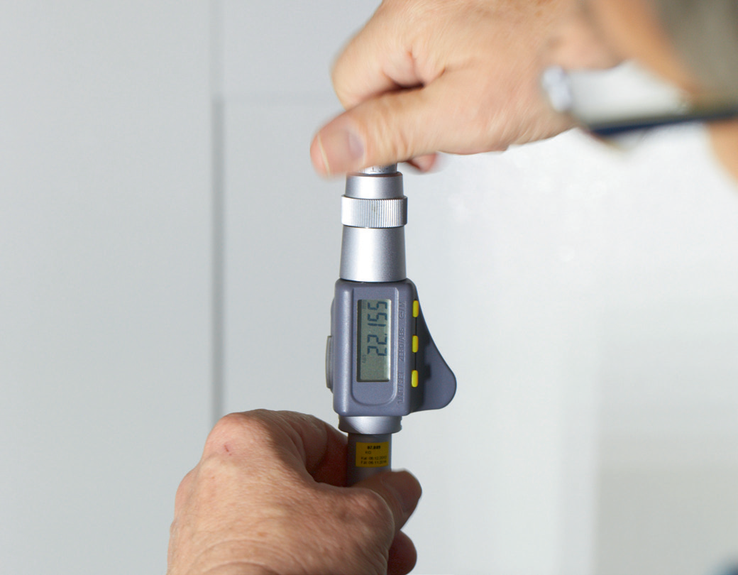

In total, more than 1,200 holes were measured and evaluated.

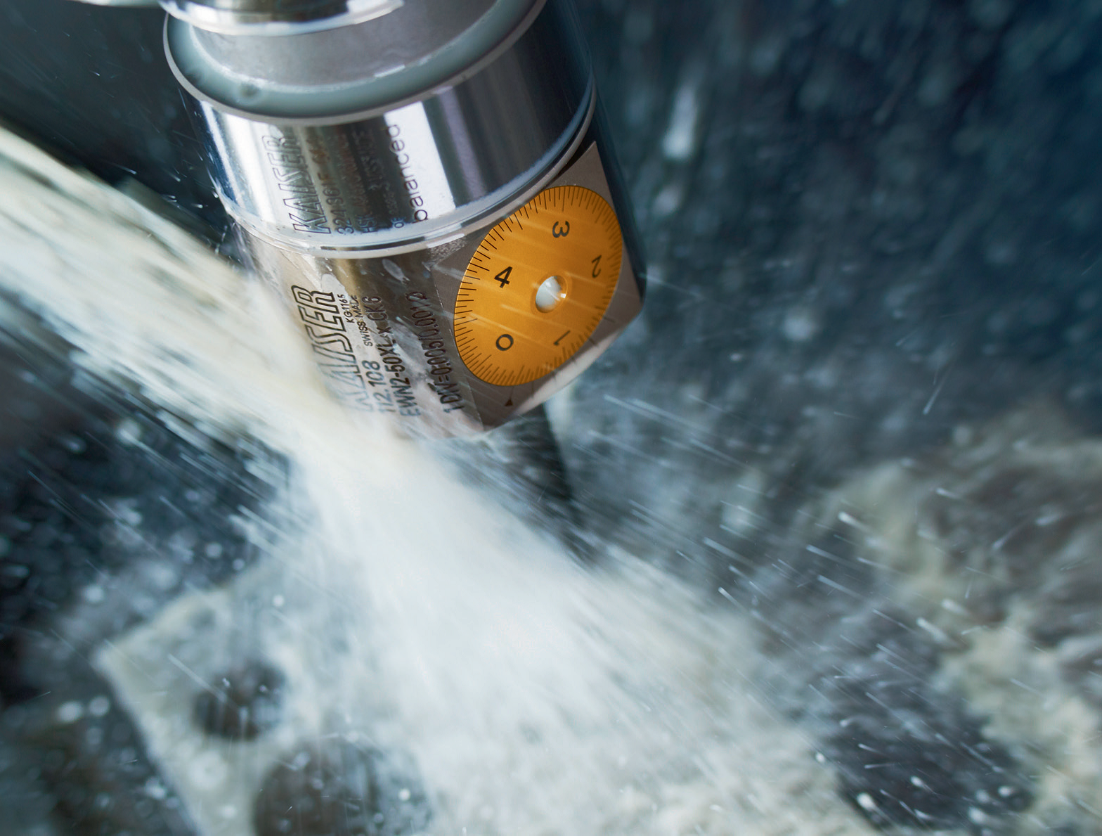

The result is surprising as only inserts recommended by the manufacturers for cutting titanium were used in the tests. The results of the combination of the Blaser coolant B-Cool 755 and the insert 655.389 from KAISER were particularly impressive: This combination resulted in deterioration to the insert of just 0.0008 inches. This was achieved after boring 81 holes with a depth of 2.008 inches and an average speed of 394 sfm, which is high for titanium.
The test tool precision boring head EWN 2-50XL.
