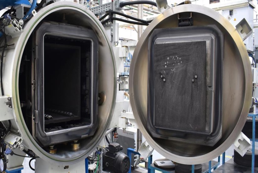

Sandvik's sintering process.

One of the most energy-intensive steps in tool insert manufacturing is sintering. After metal powders are milled and then pressed into shape, the inserts are very fragile. At this stage, the inserts are fused, or sintered, into solid pieces.
Inserts can spend up to 13 hours in a sintering oven, at a temperature of approximately 1,500°C, where they are sintered into an extremely tough cemented carbide product.
Keeping furnaces in operation for many hours at a time consumes immense amounts of energy, but cutting corners and producing fragile inserts would be even more wasteful. Reducing energy consumption requires a reduction in cycle times without compromising product quality.
Research teams at Dormer Pramet, a cutting tool manufacturer and part of the Sandvik Group, did just that. Sintering cycle times were reduced by almost 100 minutes. To achieve this reduction, Dormer Pramet engineers worked with research and development specialists from Sandvik Materials Technology (SMT) in Pune, India, to redesign the gas flow passing through the charge of the sintering furnaces.
Dormer Pramet’s facility in Sumperk, Czech Republic, is the first to trial the new sintering process. Shorter sintering cycles also means that the facility can produce more parts while using the name amount of energy.
