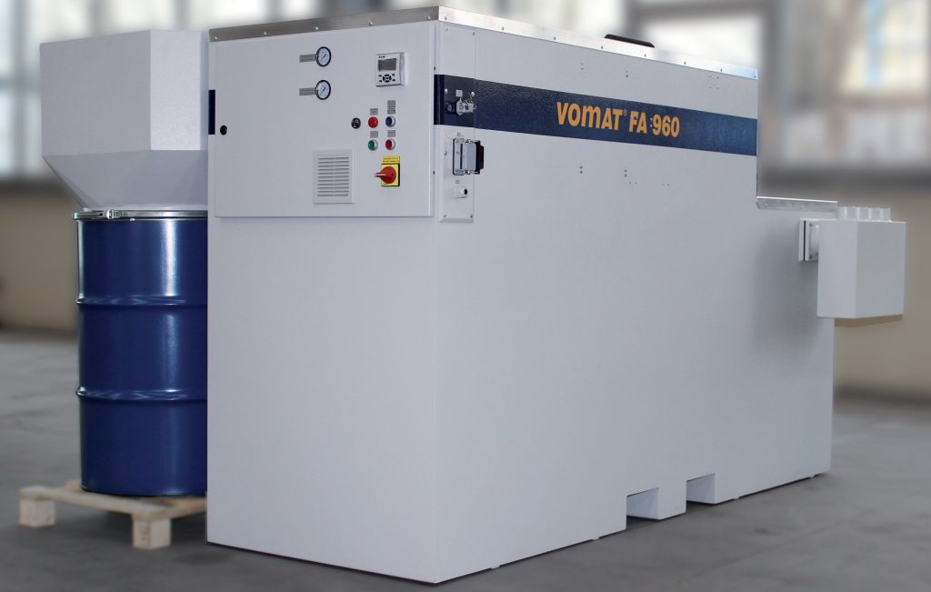

High-performance coolant filtration technology
For tool grinding, the cooling lubricant system is a crucial factor, as it provides the grinding process with the required lubrication and cooling media in purity and quantity.
Optimally filtered cooling lubricants have a positive impact on the production of cutting tools and make the grinding process more economical, while ensuring high tool quality. When cooling lubricants need to be changed less frequently, this not only reduces downtime, but also lowers costs for purchase, storage, recycling and energy consumption.
Vomat manufactures filter solutions - from individual to large-scale industrial central systems - which separate dirty and clean oil 100 percent in full flow by means of long-life high-performance precoat filters. The purity is in quality class NAS 7 (3 - 5 µm). State-of-the-art filter, cooling and disposal technology - including HSS pre-filters for mixed processing if required - ensure economic and ecological success in harmony.
In addition, Vomat filters require little maintenance and, thanks to their compact design, take up little of the valuable production floor space.
In order to optimize the operation of the ultra-fine filtration plants in terms of energy, Vomat relies on the use of efficient pumps with a high degree of efficiency. In combination with the optimized process control, unnecessary energy losses are avoided.
Vomat plants thus automatically control the filter flow and backwash cycles as required. This extends the service life of the filter elements and saves energy and costs. Compared to conventional systems, which often operate permanently at full filter capacity, Vomat systems adapt to the current production sequence. For example, when grinding machines run more slowly, only the required amount of cooling lubricant (coolant) is filtered.
If a Vomat central system filters several grinding machines and some of them are not in operation, the filter capacity is automatically adapted to the cutting volume. At the same time, less heat is also added to the medium, which in turn requires less cooling power and further reduces energy consumption.
During cleaning in the full-flow process, backwashing as required provides further advantages. This is because with Vomat filters, the backwash cycles are controlled depending on the degree of contamination of the filter elements. As soon as relevant values are reached, the time-delayed backwashing process begins for each individual filter. The other filters continue to provide a continuous supply of clean oil. This fully automatic control and regulation of the filter capacity allows energy and operating costs to be kept low.
Strobel said, "Last but not least, a particular advantage over similar filtration systems on the market is the flexibility of the Vomat technology thanks to its modular principle. Despite their compact design with low space requirements, the machines combine all the technical advantages needed for the respective requirements. On the standard platform with various plant sizes, individual problem solutions up to large-scale plants can be configured with many optional additional components and easily integrated into the respective production processes."
