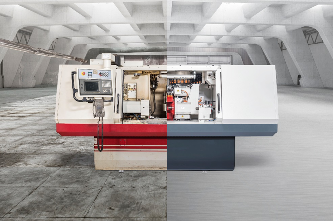

After 14 years in service, a Studer S40 grinding machine that had over 45,000 hours of run time now produces precision components to tolerances it achieved when brand new. The Studer factory in Switzerland performed the rebuild that involved completely overhauling the machine, and while doing so also provided the machine’s owner LMT Kieninger with a loaner to ensure the customer’s production would continue uninterrupted.

A rebuild, or machine overhaul, makes sense not only economically, but also in the fact that operators continue to run a machine that is familiar to them for a seamless transition after the machine has been rebuilt.
In the Studer factory, the rebuild specialists disassemble machines down to all their individual parts. The specialists completely refurbish guideways, overhaul the assemblies and replace all worn electrical cabinet components, as well as all worn hydraulic and lubricating systems and valves. If spare parts are no longer available, Studer provides alternative solutions. For the final stages of the rebuild, the casting and components are sand-blasted and receive a fresh coat of paint. Once reassembled, the machine’s geometry is like that of a new machine.

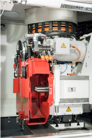

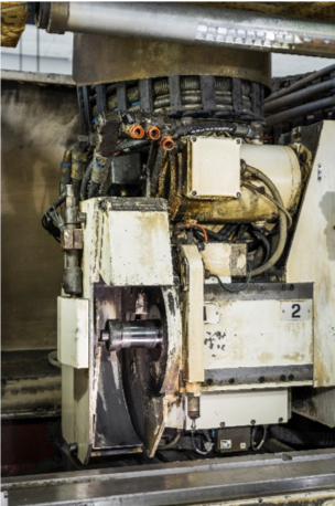

A Studer grinding headstock before and after the rebuild.

Studer machine overhauls enable a second life for a grinder.
