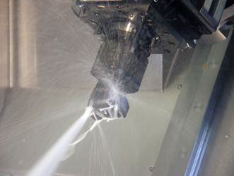

Thanks to WFL's own spindle development, the cooling lubricant can be directly fed to the cutting edge through the milling spindle at a pressure measuring up to 200 bar. This ensures rapid, continuous removal of swarf.

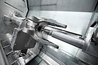

Top: Thanks to WFL's spindle development, the cooling lubricant can be directly fed to the cutting edge through the milling spindle. Above: As well as the Millturn complete machining centers, WFL provides software solutions in the form of tailored machining strategies, process design, and programming.

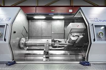

Titanium 5553 (Ti5Al5V5Mo3Cr) is required for the production of landing gear in the aviation industry. It has improved properties about strength, toughness, and increased heat resistance. However, it is currently one of the most difficult-to-process materials.
Problems like point heat due to poor heat conduction and associated chemical changes in the material (embrittlement at higher temperatures) and the formation of built-up edges occur to a greater extent with this material than with other titanium alloys.
Therefore it is important that cutting speed, feed rate, and penetration depth are matched to one another accurately when working with Ti 5553. The use of suitable cooling lubricants is just as important as the correct cooling strategy. A quick and continuous removal of the swarf must be guaranteed; the heat dissipation occurs to a much greater extent via the tool.
