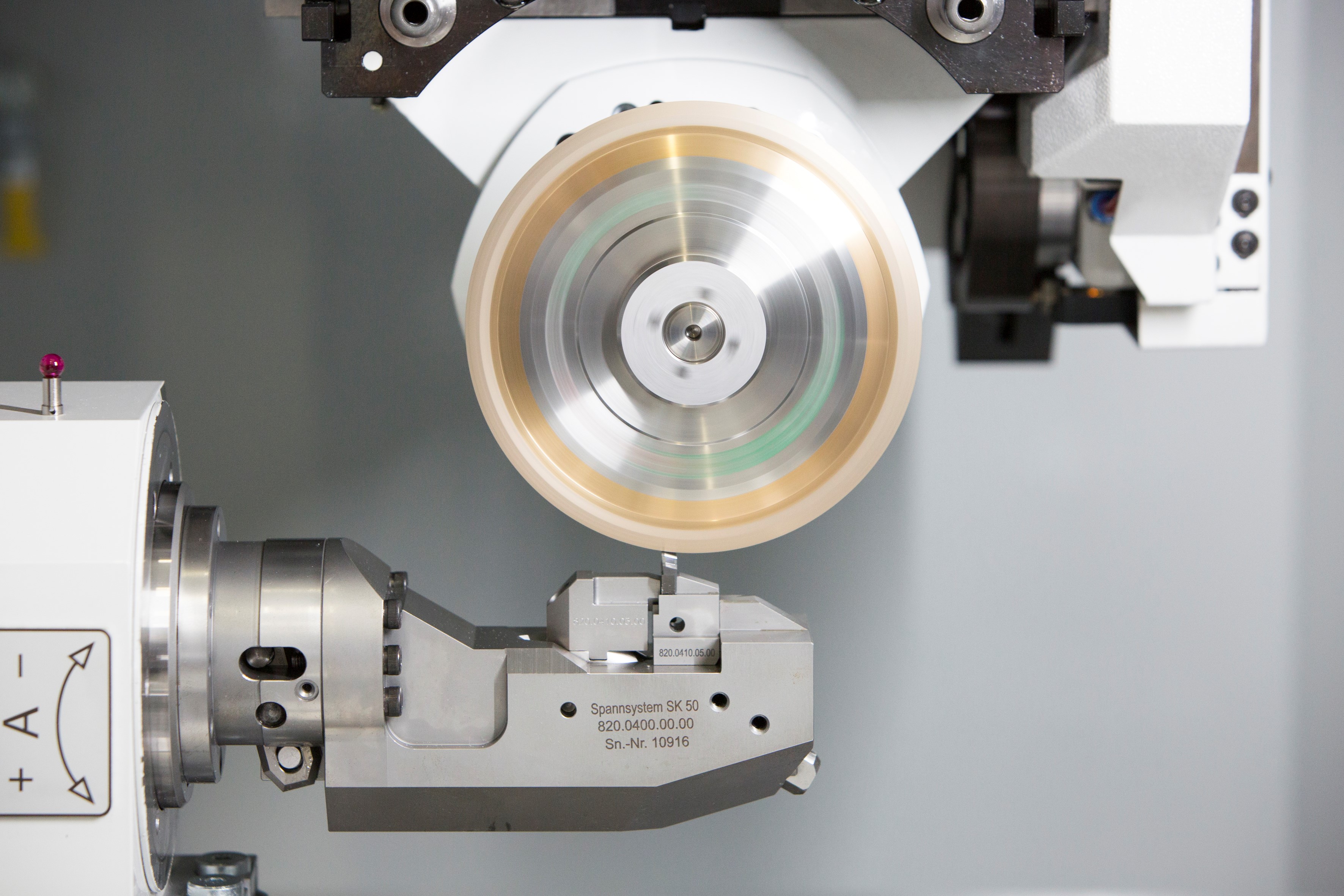

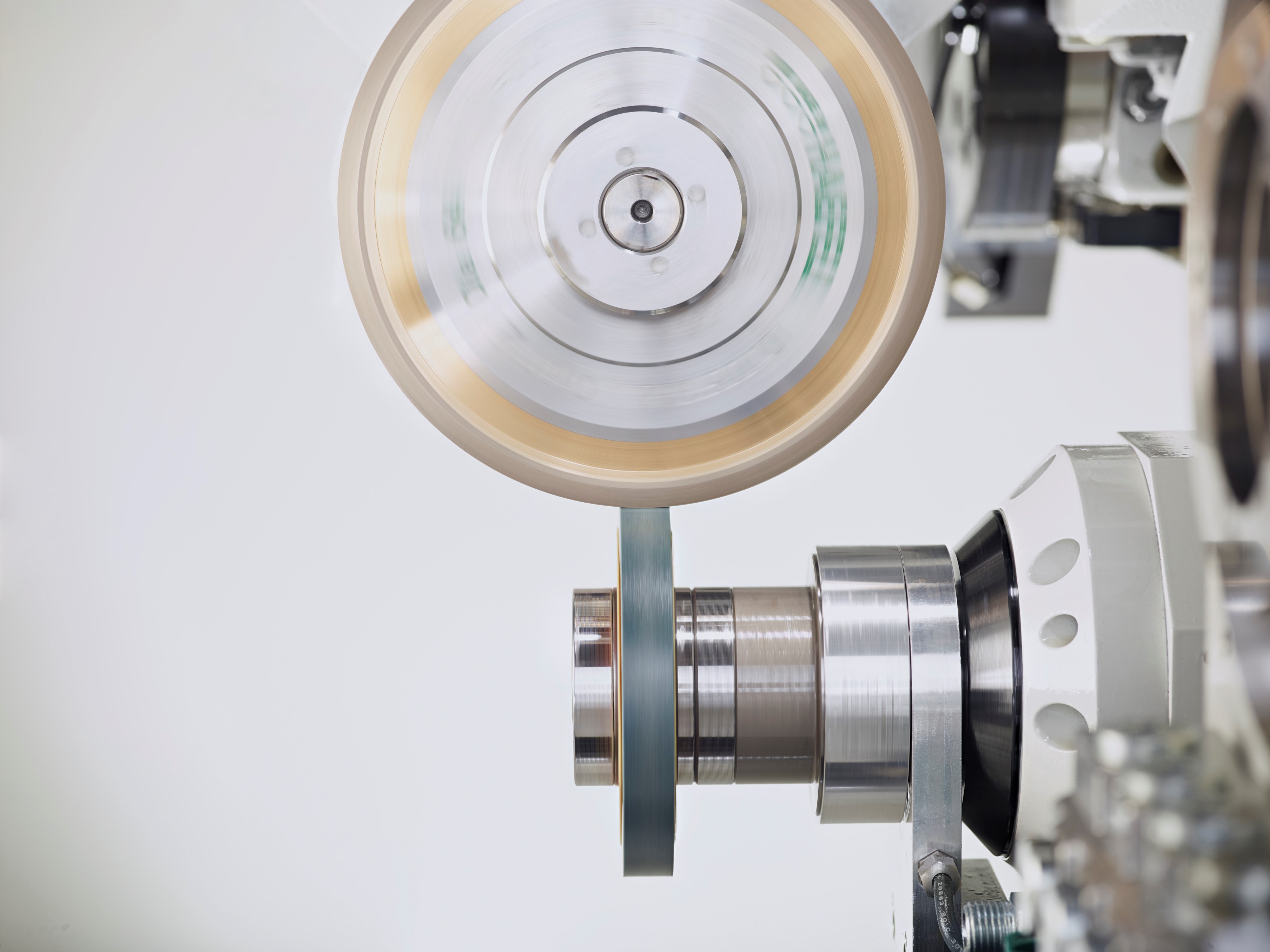

XING dressing a tapered diamond grinding wheel, which is positioned at a 90° angle to the dresser wheel. Photos courtesy of Haas Schleifmaschinen
Dressing with profile accuracy
But the extremely precise tapered diamond grinding wheels often feature an edge radius of just a few hundredths of a millimeter and are correspondingly sensitive, which is why we at Haas opt for the XING dressing technique. The dresser wheel axis isn’t positioned parallel to the grinding wheel axis, as it is with other techniques, but rather at a 90° angle, meaning the silicon-carbide or corundum wheel often associated with other diamond grinding wheels can be used for dressing. Thanks to the NC-controlled process, the radius of the grinding wheel can be generated with the circumference of the dresser wheel, thus maintaining a consistent contact surface and pressure between dresser wheel and grinding wheel. The benefits of XING dressing include a lower pressure load and higher profile accuracy for the grinding wheel.
Machining a profile insert for machining on a Multigrind CU grinding machine.
Dressing without unclamping and rechucking
Like all other dressing techniques at Haas, XING dressing is also carried out inside the grinding machine, so there’s no need to unclamp and rechuck the grinding wheel. That has a positive effect on dimensional accuracy, while the grinding wheel boasts better radial and axial runout, making it possible to generate better surfaces. This is something you can actually hear while grinding – the wheel sounds much “healthier” during the grinding process.
