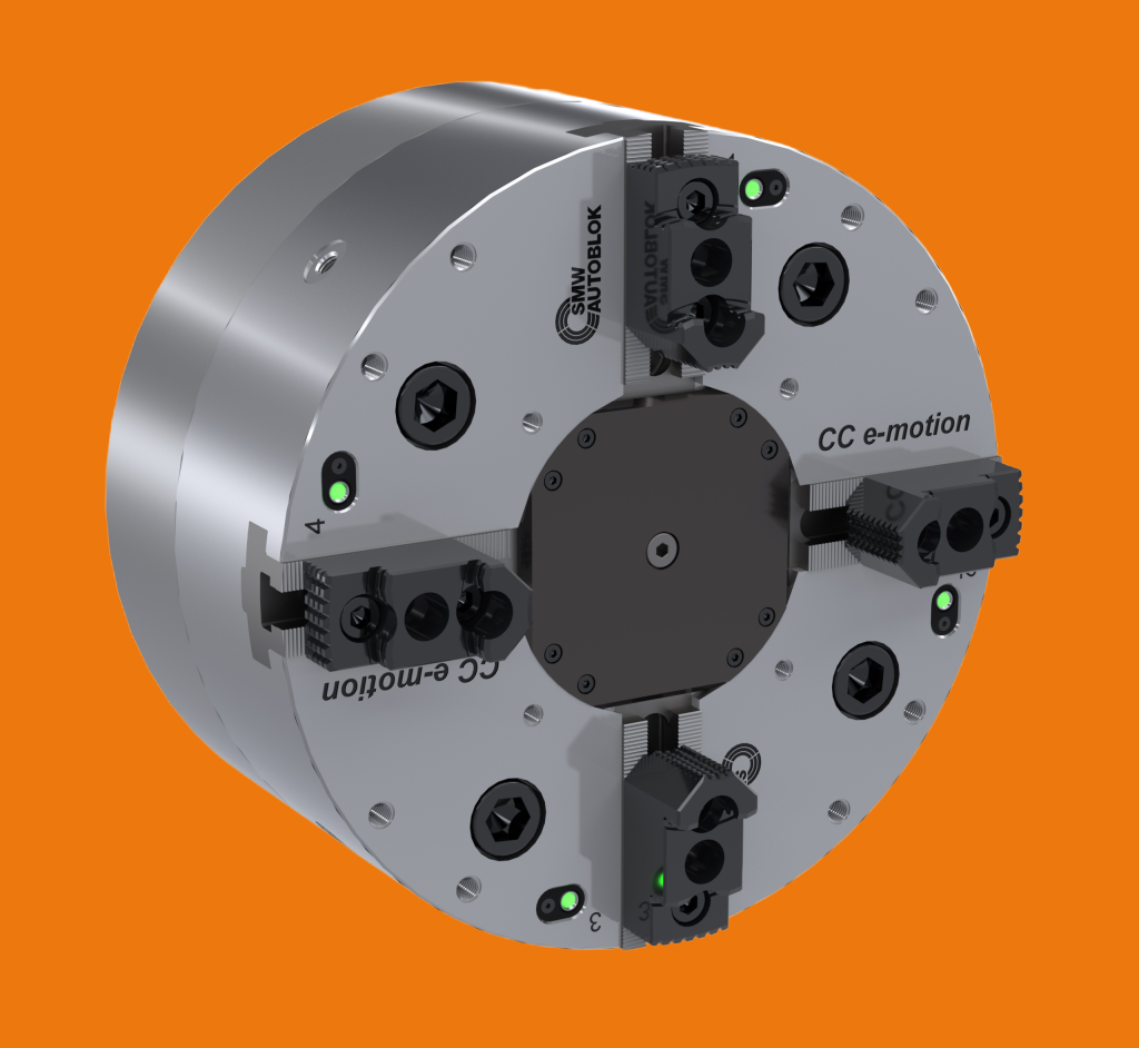

CC E-Motion Electric Chuck Features Plug and Play Installation for Power and Signals
SMW Autoblok sets a new standard for power chucks with the introduction of the CC e-motion electric 4-jaw chuck featuring wireless power and signal transmission (up to a 20 mm distance) utilizing an F180 Ethernet base inductive coupler system and high repeatability of < 5 µm.
Ideal for everyday use, the CC e-motion offers unbeatable accuracy and flexibility for high or low volume turning, inspection and finishing operations while providing fast, seamless machine integration. Optimum for either heavy duty or precision machining of any workpiece geometry, the chuck allows users to not only program the cutting cycle, but the jaw movement and gripping cycle as well.
Whether the application requires highest accuracy or high-low chucking, the individual
electro-mechanical single jaw drive of the CC e-motion allows grip force setting to any value as well as automatic radial fine adjustment of the workpiece. There is no other fully integratable chucking system available on the market making this programmable power chuck completely revolutionary to the industry. Plus, the ability to handle any workpiece shape and configuration of parts means fewer changeovers and vastly reduced downtime with dramatically improved part quality.
Designed to meet the demands of manufacturing automation and Industry 4.0, CC e-motion includes redundant safety monitoring that displays the status of the chuck while in operation, letting the user know if the chuck is open, closed, improperly clamped or has insufficient clamping force—all at-a-glance—a definite game changer!
Each jaw of the CC e-motion is independently controlled and monitored by a single mechatronic drive providing automatic correction function and the ability to change the grip force in process without removing the part. The chuck body and internal parts are case hardened for increased chuck life and highest rigidity, precision, and durability, and accept standard inch serrated top jaws.
The plug and play CC e-motion uses the innovative F180 Ethernet base coupler system that transmits up to 400 W of energy and data contact-free through an air gap of up to 20 mm between rotating and stationary components. The IP67 rated coupler is wear and maintenance-free and is ideal for use as slip rings or connector replacements as well as other applications.
