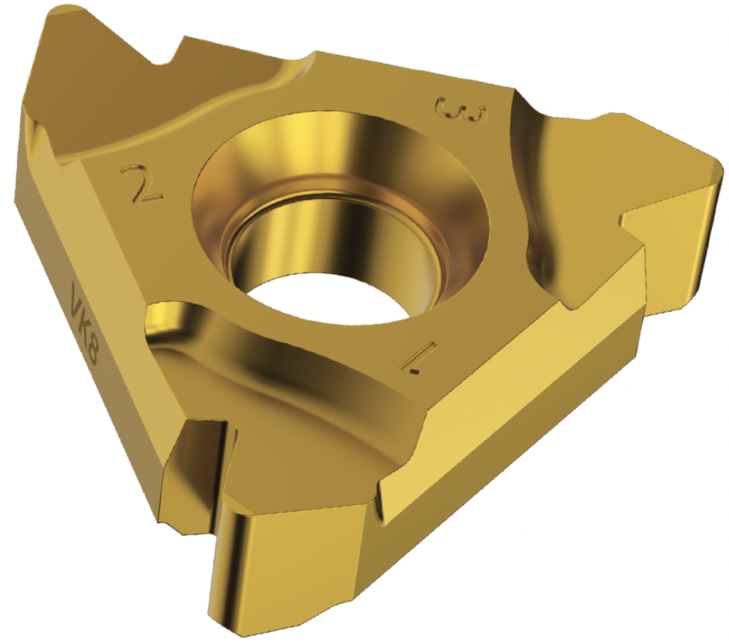

Vargus introduces the expansion of their Mach TT Line! It now includes internal threading solutions IC 3/8" (16) IN RH. The new Mach Line is now included in the VARGUS GENius™, an advanced Tool Selector and CNC Program Generator in the metal cutting tools industry.
Features:
• Improved Rake & Reinforced Geometry - for high resistance with a reduced number of passes
• Grade - high wear resistance for general purpose applications. AlTiN + TiN PVD coating • Improved Profile Design - superior threading surface finish
• Advanced Surface Treatment - reinforced cutting edge and smooth surface finish • Vargus Dovetail Clamping System - super rigid, designed for high loads
• Eccentric tool overhang design - for deeper threads and improved stability
Available Standards:
Partial 60 | Partial 55 | ISO | UN | W | BSPT | NPT | NPTF | RD405 | Trapez | UNJ | MJ | Metric Buttress | APIRD
Benefits:
• Significantly reduces the number of passes
• Dramatically decreases machining time
• Extended tool life
• Excellent surface finish
60% less passes, 60% less machining time, 50% more tool life.
