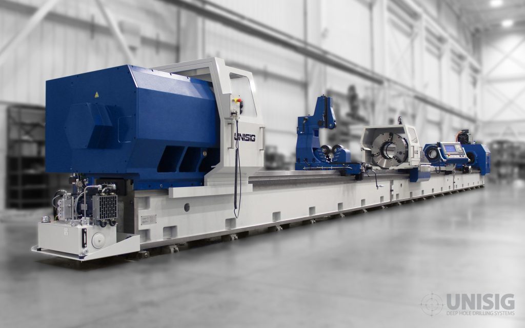

UNISIG has unveiled newly developed technologies that substantially improve performance while reducing cost in its larger B-series machines. These advances are introduced in the newly launched B850 model and will be integrated into larger models in the series. When designing the B850, UNISIG evaluated all aspects of the previous designs. The
bed and rack-and-pinion system were retained, while feed systems were modernized to improve rigidity and reduce backlash. A new high-performance, helical-geared transmission was incorporated in a three-range, automatically shifting headstock.
Incorporation of modern gearing and power train concepts simplified construction of the machine, reducing cost and boosting reliability and performance. The B850 also offers a standard programmable coolant system. Combined with userfriendly controls and the other new design features, the machine allows an operator to focus on the part being machined instead of managing a wide variety of manual functions.
Both the work and tool headstocks deliver 166 hp, providing the high power and torque needed to drill holes up to 7.1” (180 mm) in nickel alloys, 8.7” (221 mm) in carbon steel, and 12.6” (320 mm) with counterboring. The B850 model is available with maximum drill depths ranging from 78” to 65’ (1.98 m to 19.81 m), and the machine bed can
accommodate workpieces up to 10 tons (9,071 kg).
The B850 is part of UNISIG’s extensive B-series line, designed for on-center drilling of round workpieces in applications such as aerospace, defense, and oil and gas. In addition to standard BTA drilling methods, these machines are also capable of counterboring, trepanning, and skiving and roller burnishing processes, achieving the extremely strict tolerances required by manufacturers in these and other industries.
