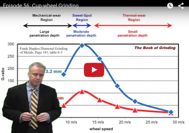

For one shop, increasing wheel speed when cup-wheel grinding usually reduces wheel wear, but sometimes it increases wear. The shop sought the advice of Dr. Jeffrey Badger in the 56th episode of our Grinding Doc Video Series.
