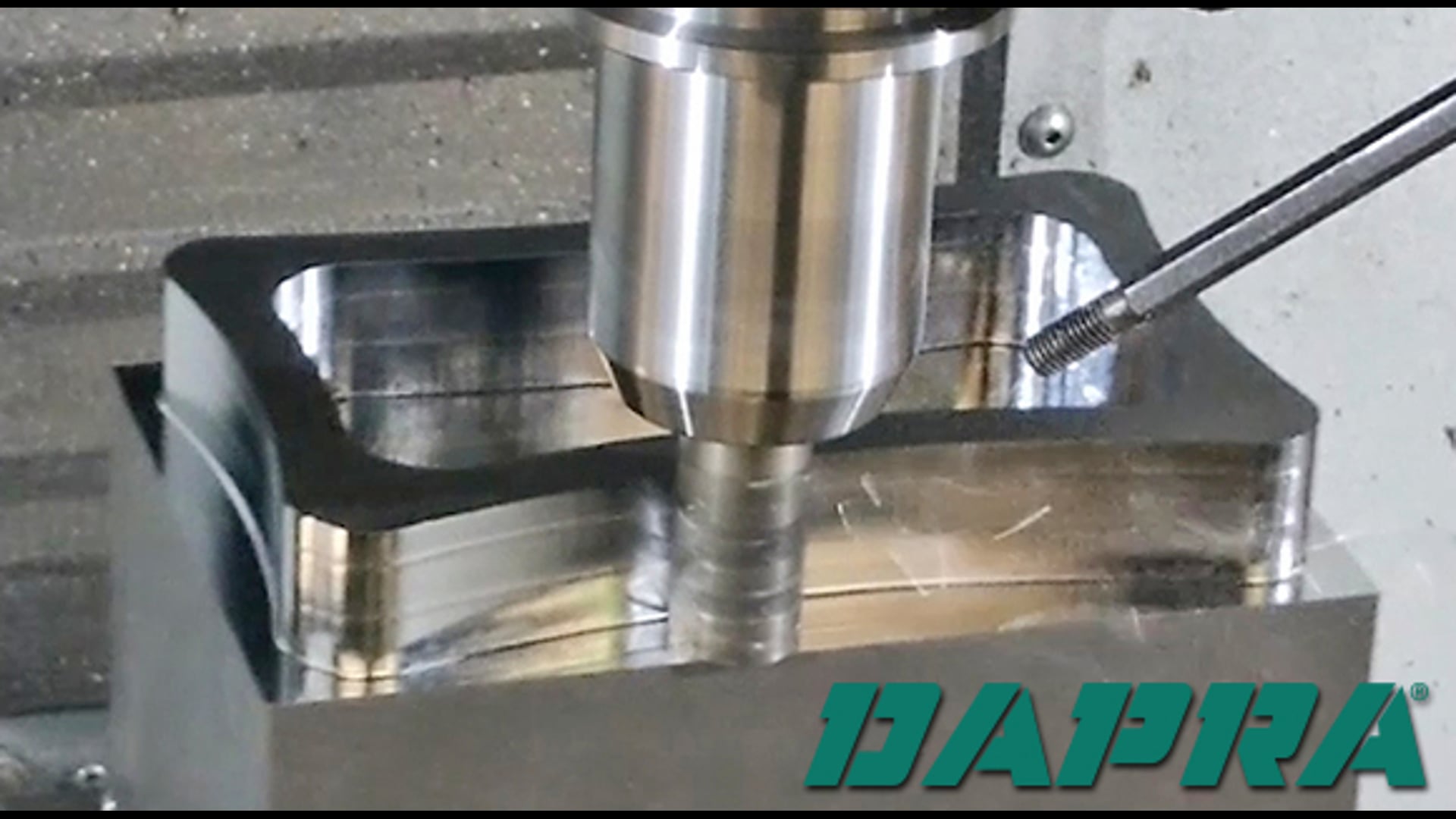

Curious about Dynamic Milling? DAPRA’s American-made Helical Roughing End Mills are a great option for modern applications. Watch a 3/4" dia. end mill create a 0.850" deep pocket and outside contour in a 4" wide x 6.25" long 1018 steel block, with a total cycle time of just 4 min. 17 sec.
  • 0.25" wall thickness; 0.625" max. radial depth
  • Pocket and outside contour: 0.060" WOC, 6100 RPM, 185 IPM, 0.850" DOC
