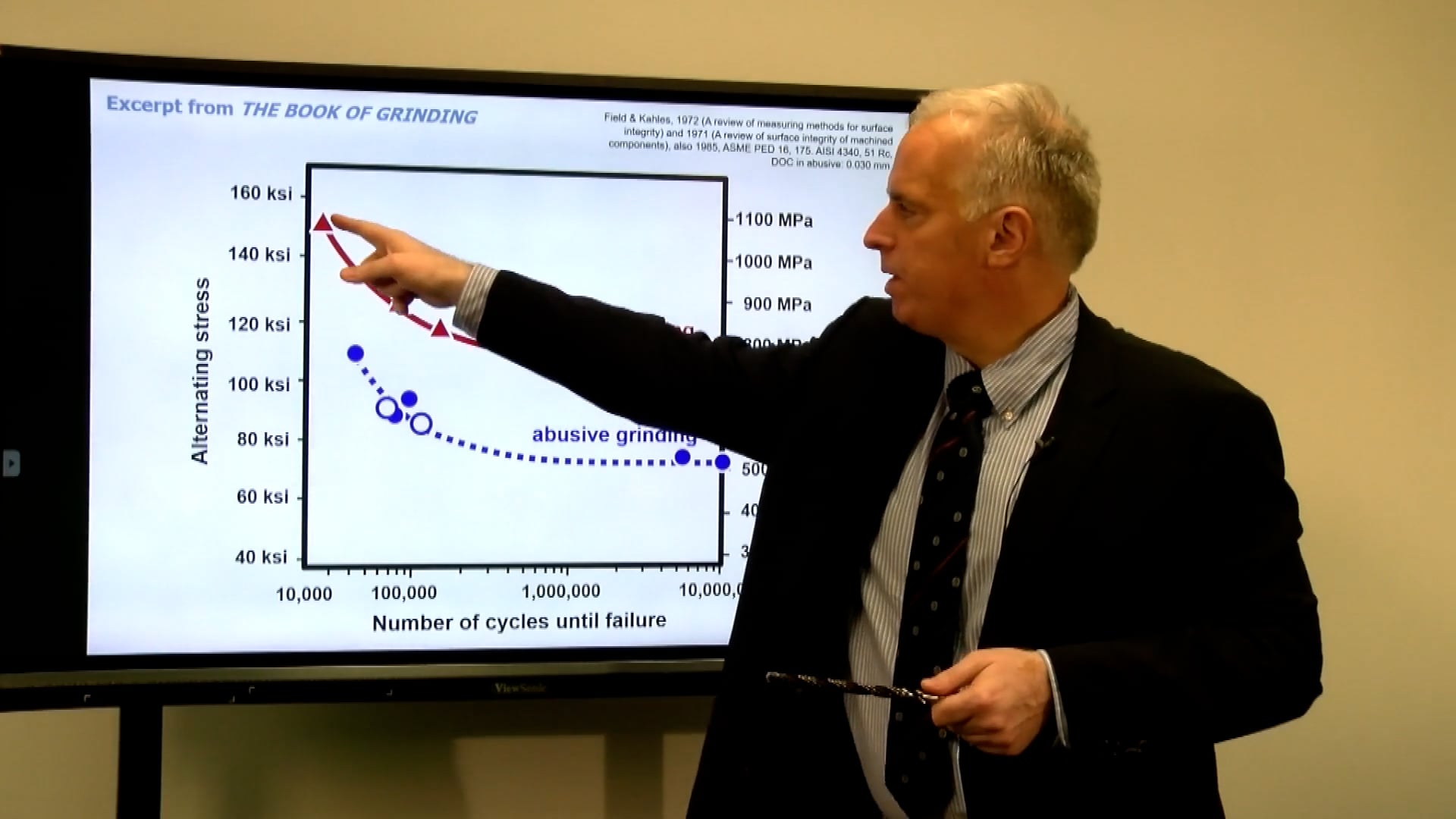

For the 102nd Grinding Doc episode, Dr. Jeffrey Badger covers the impact that thermal softening, residual tensile stresses and rehardening burn have on fatigue life in steel workpieces.
