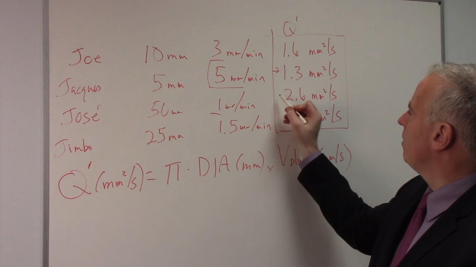

The Grinding Doc favors the Q-prime calculation over feed rates when assessing the productivity of a cylindrical grinding operation.
