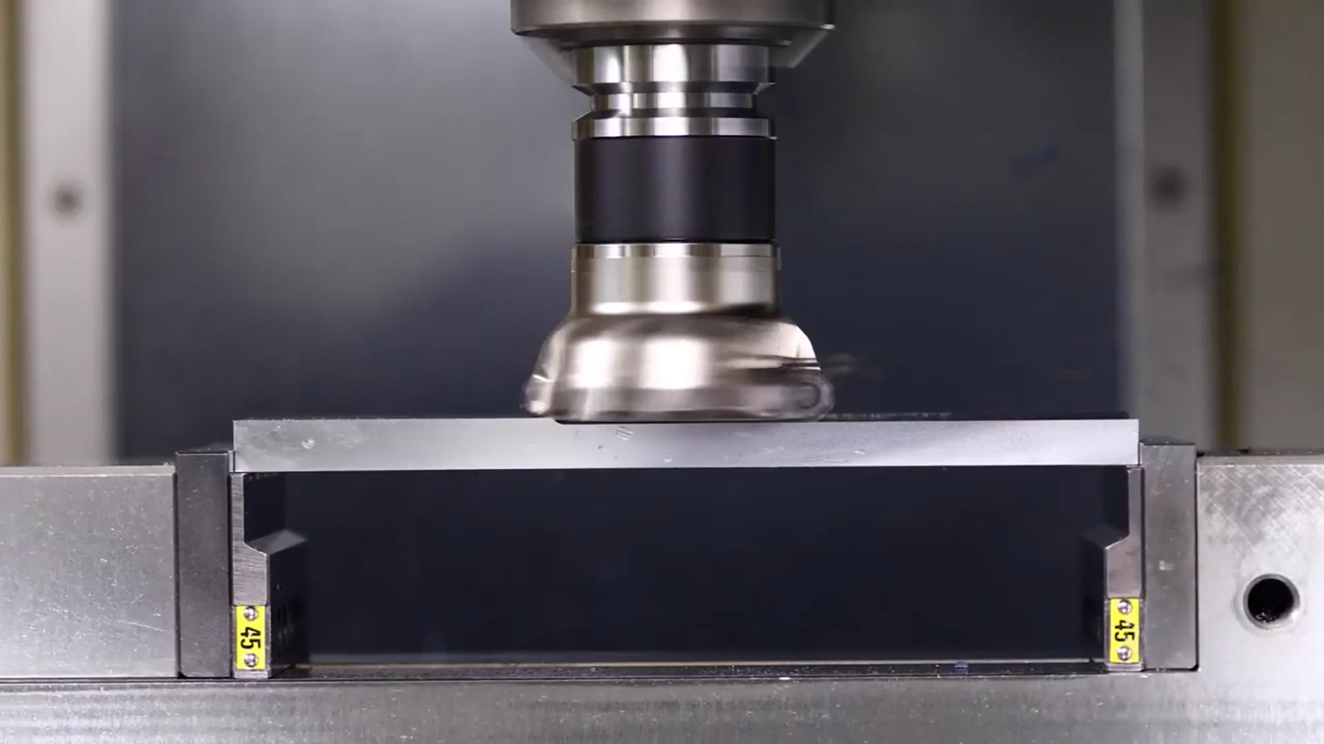

Tungaloy's TungEight-Mill face milling cutter is for extremely light cutting with low power consumption, perfect for low rigidity and low horsepower machines with a BT-30 connection. TungEight-Mill incorporates single-sided positive inserts with eight economical cutting edges for heavy roughing to mirror finishing of various material faces. A high positive rake angle of the insert and its optimal orientation on the cutter contributes to forming a helical shaped chip, allowing smooth chip evacuation and application security. The feature is particularly effective when machining low carbon steel and stainless steel with chip breaking difficulty and tendency to smear.
