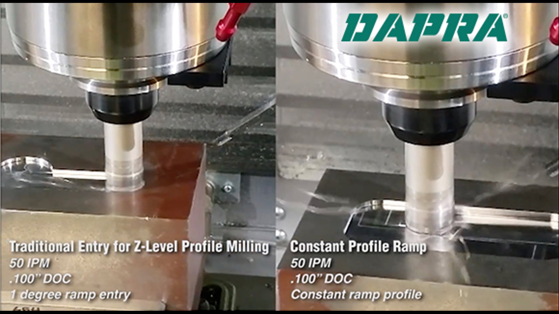

Are you maximizing your Profile Milling efficiency? Constant profile ramping is a much more effective approach than conventional Z-level profiling. View the striking difference side-by-side as a Dapra 1” end mill (50 IPM / .100” DOC) using constant ramp profile outpaces a traditional 1° helix entry and Z-level rough by more than 50%.
  • Left: Traditional entry for Z-level profile milling – 9 min., 7 sec. total cycle time
  • Right: Constant ramp profile – 6 min. total cycle time
