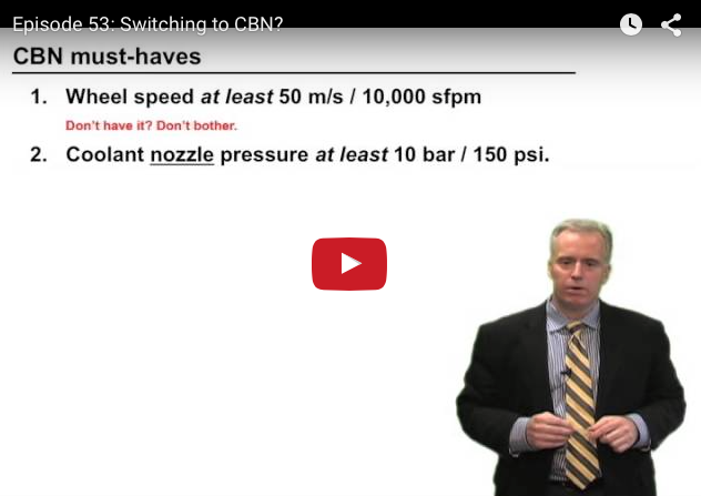

Switching to CBN?
Published Date
July 21, 2014 - 06:30:pm
Dr. Jeffrey Badger, the host of Cutting Tool Engineering's Grinding Doc Video Series, offers a checklist for shops contemplating a switch from aluminum oxide to CBN wheels.
About the Grinding Doc Video Series: Thanks to his work as an independent grinding consultant and the author of the "Ask the Grinding Doc" column in Cutting Tool Engineering magazine, Dr. Jeffrey Badger routinely receives questions about grinding from shops all over the world. Through the magazine column and this video series, he provides shops with the insight and guidance they seek.
