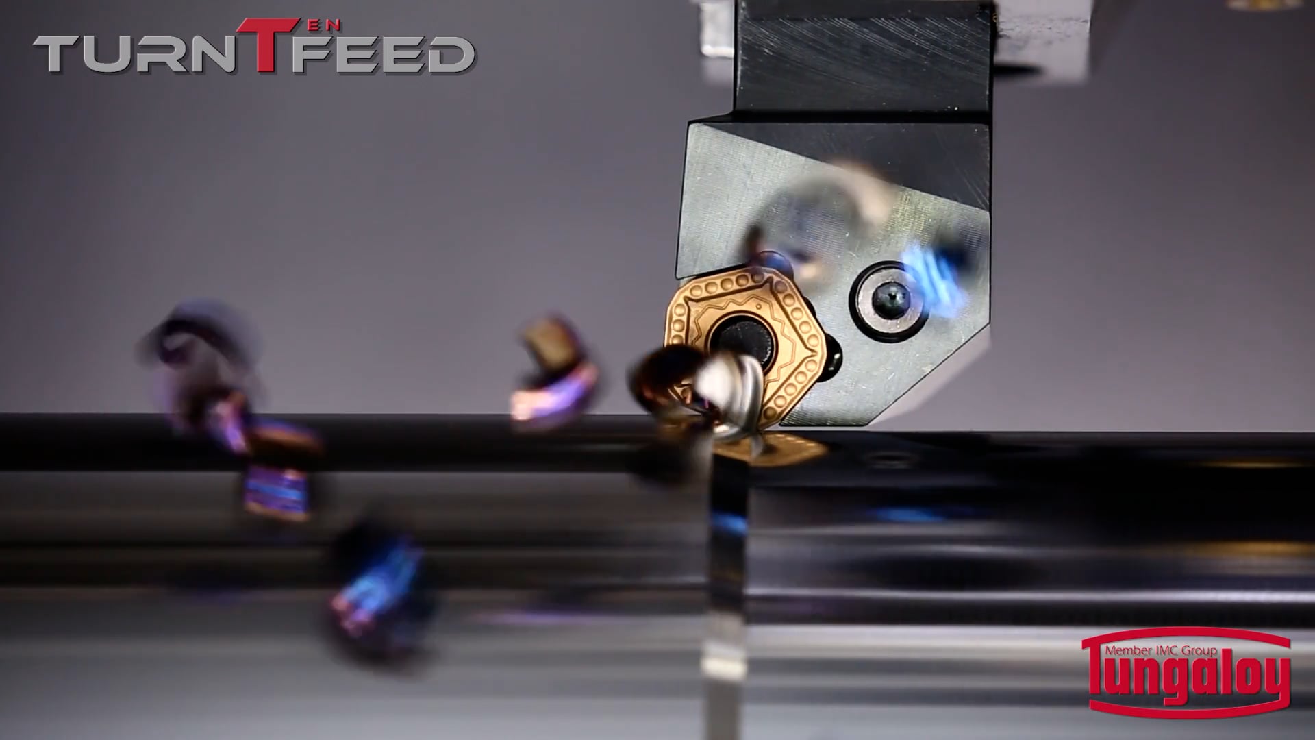

Components for the aerospace, power and heavy equipment sectors require high material removal rates and extended machining hours. These expensive components require high machining reliability and tool life predictability. TurnTen-Feed provides that tool reliability and machining efficiency in medium-heavy turning. The insert features 10 cost-efficient cutting edges. It’s double-sided and securely mounted with a dovetail clamping system, ensuring high reliability and stability. The MNW chipbreaker ensures smooth chip flow, while the built-in, cutting-edge wiper geometry allows high feed motion of up to 0.079" (2 mm) per rev to be applied for accelerated machining. Two types of holders are available and can accommodate either type of insert.
