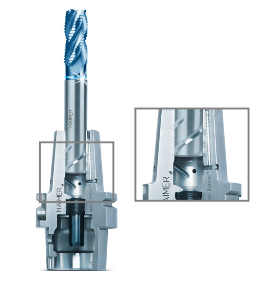

The Safe-Lock™ System from HAIMER is an integrated pull out protection for round cutting tools that uses a friction and form locking system.

The MRR improvement, however, “can lead to a potential pull-out of the cutting tool during aggressive machining due to higher helix angles and increased cutting forces,” the company explained. This led Melin Tool to look for a solution that enables the comany’s endmills to realize their full cutting speed potential. That search led to the licensing agreement for the Haimer Safe-Lock System.
The Safe-Lock design in cutting tools and toolholders reportedly combines high-precision, shrink-fit clamping with a positive form locking mechanism. The design is said to prevent round cutting tools from being rotated or completely pulled out from toolholders during heavy machining, and results in a vibration-free machining process.
