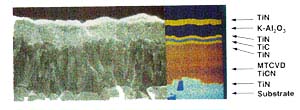

MTCVD coatings, as the name implies, are deposited at lower temperatures than CVD coatings. The lower temperatures eliminate cracks in the coating. As a result, MTCVD coatings offer the advantage of having increased toughness and smoothness without sacrificing wear resistance or crater resistance. Tools with these coatings cover broader application ranges for ferrous materials, allowing consumers to inventory fewer grades and, therefore, suffer fewer application mistakes.

Figure 1: Scanning electron microscopy photographs of the microstructures of a multilayer CVD coating (A) and a multilayer MTCVD coating (B).

Figure 1 illustrates the microstructural differences between CVD and MTCVD coatings. While the thicknesses of the different layers vary, it is apparent that the structure of the TiCN layer is different, depending on the deposition conditions.
Lower deposition temperatures yield crack-free coatings. Because the coating layers have differing levels of thermal expansion, cracks always form in traditional CVD coatings when the tools cool off after deposition. These cracks are clearly visible during metallographic analysis. Careful analysis has shown that few or no cracks are present in MTCVD coatings. This lack of cracking accounts in part for the increased toughness of these coatings. Semicoherent grain boundaries probably also contribute to toughness.
