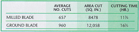

Accurately set teeth on a rigid, well-maintained production power bandsaw can produce cuts with a 125µin. to 250µin. finish and an accuracy (in terms of flatness and parallelism) in the 0.002″ range per 1″ of workpiece height. After the teeth are set, the blades are hardened and multiple-tempered by heating and cooling in controlled-atmosphere furnaces to improve both hardness and toughness. Typically, HSS tooth tips on bimetal blades are hardened to RC 66 to 69.
Testing
Factory tests have verified that a precision-ground bandsaw blade delivers longer blade life than a milled blade can. In a typical comparison test, cuts were made on 4″ round AISI 4150 steel, using 1 1/4″-dia. bimetal blades with a 2-3 pitch on a production power bandsaw cutting at 12 sq. in./min. (Table 1). As indicated in Table 1, the ground blade cut 3580 sq. in. more steel than the milled blade – an increase of 42%. The time elapsed before there was a need for a blade change went from about 1 1/2 shifts to slightly more than 2 shifts.
Grinding Your Teeth
Table 1: Cutting performance of a ground blade and a milled blade
