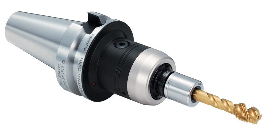

BIG KAISER's MEGA Synchro drives taps securely and compensates for the small synchronization errors common with many CNC machine tools. Image courtesy of BIG KAISER Precision Tooling.

  • With synchronous, or rigid, tapping, avoid using ER or comparable collet-style toolholders. A number of tooling suppliers offer holders that grip and drive the tap more securely than a collet. These holders also provide a small amount of axial "float" to compensate for the spindle-to-Z-axis synchronization errors common with many CNC machine tools. On a related note, thread mills should be gripped like any other milling cutter: with a well-maintained milling chuck or shrink-fit holder.
