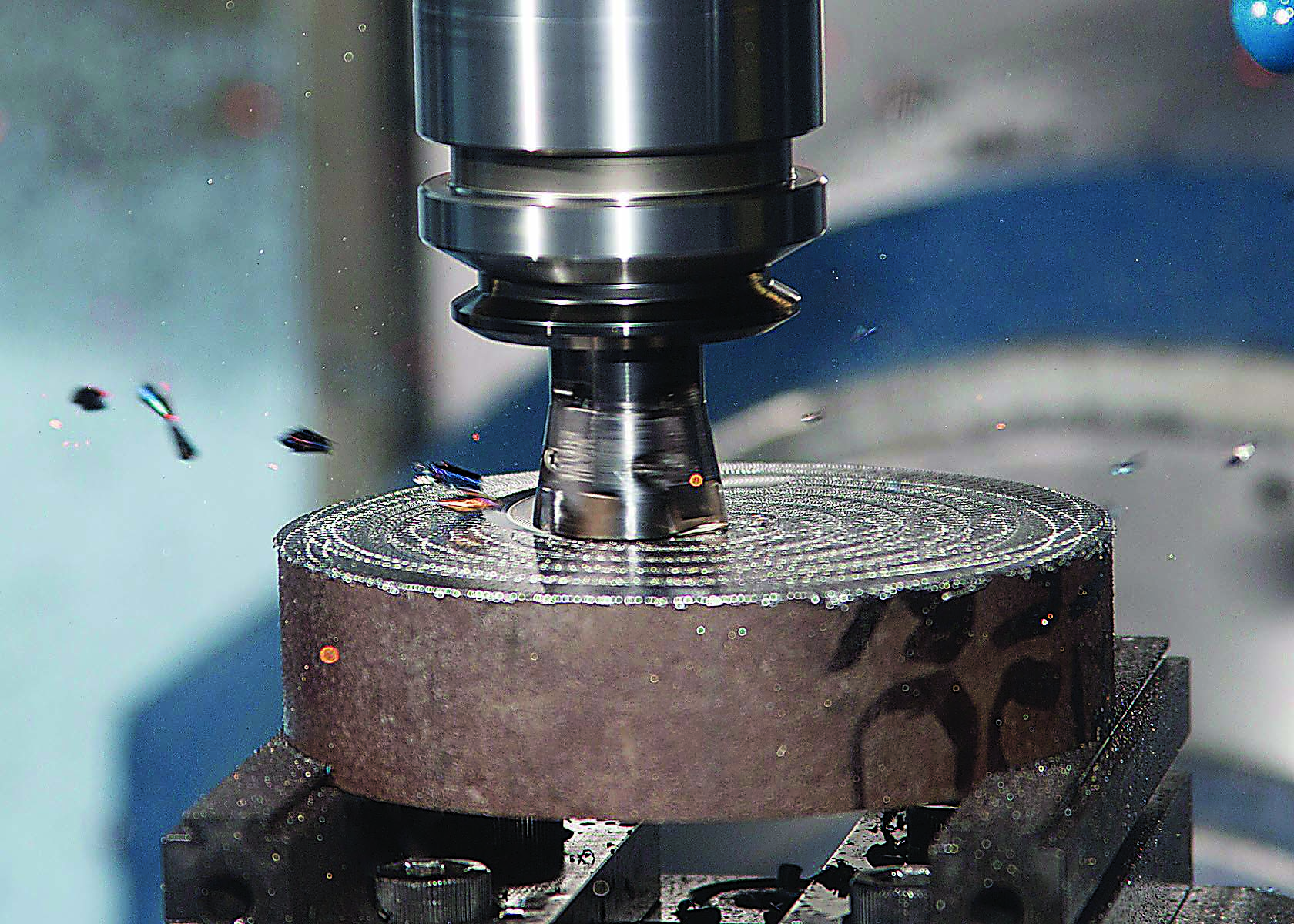

Image courtesy of Greenleaf.
Wouldn’t it be cool, though, to toss out those HSS corncob roughers with their 5-ipm (127mm/min.) feed rates and leverage some of these more productive milling methods?

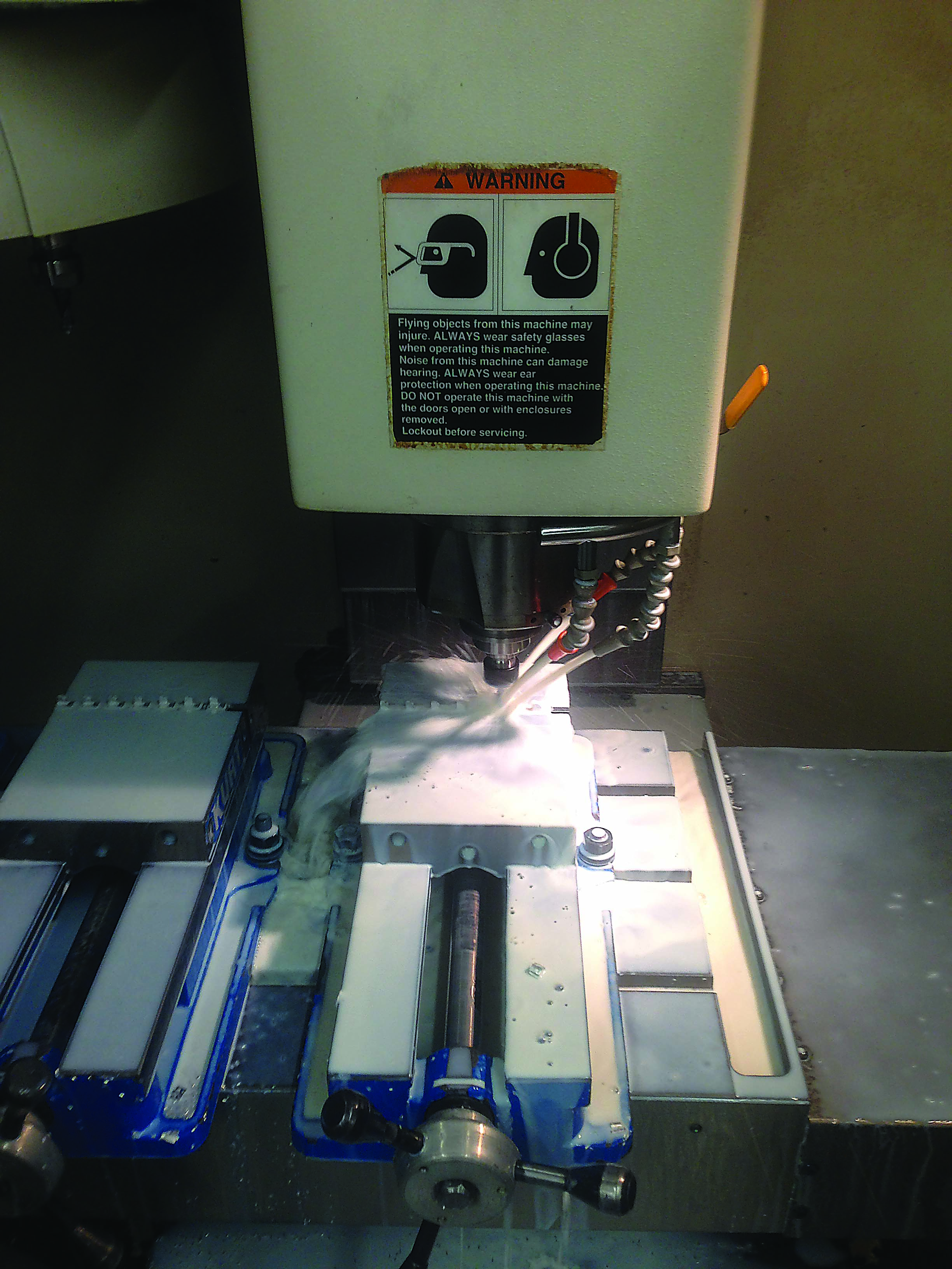

Unless special plumbing is installed, some carousel-style toolchangers can limit cutting fluids to the right side of the spindle, inhibiting chip flow. Image courtesy of GWS Tool Group.

Happy With High Feed

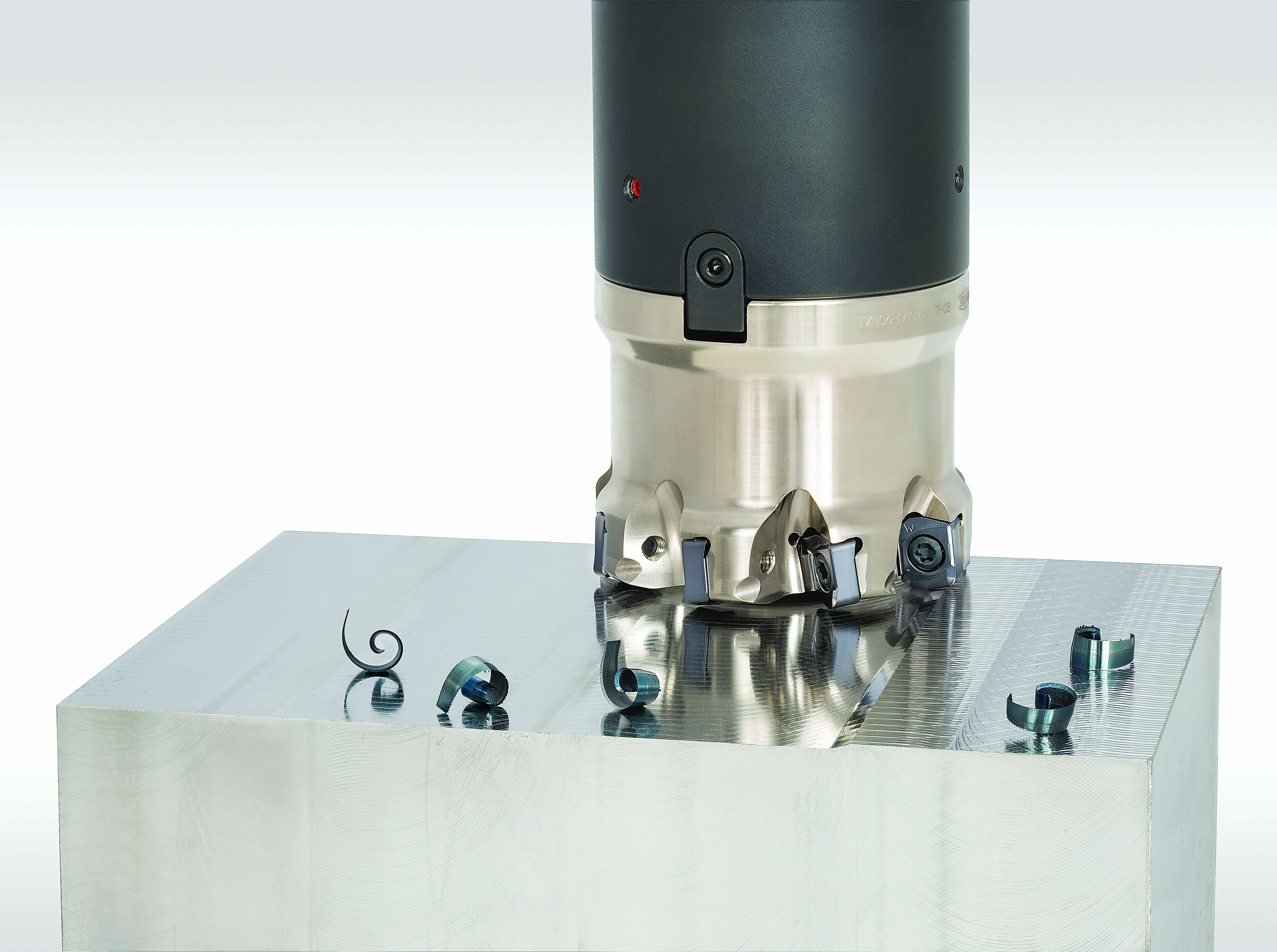

One milling strategy that works especially well on older machines is high-feed milling. Most often, a special resembling a flattened ballnose endmill is applied with a shallow Z-axis, or axial, DOC, relatively heavy radial engagement (upward of 50 percent) and high feed rates, all of which tend to thin the chip while directing cutting forces into the spindle. Roman said one customer was able to replace seven separate tools with a pair of high-feed milling cutters, reducing cycle time and tool costs alike.
Vic Dodd, rotating-product manager for Tungaloy America Inc., Arlington Heights, Ill., saw similar results from his own days in the shop. “I once had a couple of 1997 Bridgeports that I used for mold work and had great results with high-feed tools,” he said, adding that with older equipment like that, the spindle isn’t strong and the servomotors are weaker than those found on newer machines. “The programmers need to understand those limitations if they’re to utilize what’s available.”
Indexable high-feed milling cutters are an effective machining method for old and new machines alike. Image courtesy of Tungaloy America.
Another limitation that many might recognize is coolant flow. With many older machining centers, Dodd explained, the horizontal, carousel-style toolchanger sits on the left side, a configuration that places the coolant lines on the right side of the spindle. “The problem here is that when you’re climb milling on the back of the part, the coolant is forcing the chips back into the cutter. That causes nothing but problems.”
Blast Away
There are two ways around this obstacle: Adjust the toolpath accordingly or turn off the coolant and apply an air blast. According to Dodd, the latter should be used by anyone cutting carbon steel, most tool steel and even some stainless steel. “Everybody wants to stick coolant on everything. It’s not really an advantage anymore in today’s modern machining. About the only time it is needed is when you’re drilling and tapping.”
