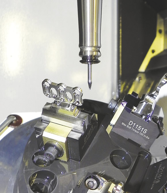

St. Martin focused on the PY6420D1151S clamping system, which utilizes a dovetail-shaped clamp to grip premachined workpiece blanks from one edge, allowing access to five sides in one machining operation. The operator places the material in the fixture, tightens an Allen screw and the clamping system draws the material down onto the ground face of the fixture, ensuring repeatability in the Z-axis.

Alphatec_TrestleLuxe.tif
Courtesy of Alphatec Spine
Multiaxis profiling on a 24mm-long Trestle-Luxe anterior spine plate at Alphatec Spine using workholders from 5th Axis Fixtures.
Initial results with the 5th Axis workholders were excellent, reducing the number of operations on the Mikrons from three to one. Since then, the process has been further improved. “We’ve taken a lot of machining time off the Mikron spindles by moving the roughing operations to our Haas vertical machining centers,” St. Martin said. This simple step eliminated 25 minutes of cycle time on the most expensive machines in the shop and significantly reduced overall manufacturing time.
