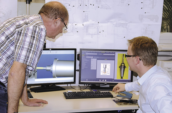

Prior to incorporating TMS, CAM programmers were producing NC programs for machining bogies using a 2½-D CAM system, which was time-consuming and error-prone, according to Michael Kringe, the company’s applications specialist. “We programmed from 2-D drawings, which meant we never really knew what the chassis looked like and if we had properly taken into account how to machine all of the interference edges,” he said.
In addition, the CAM programmers could only specify tools to a certain extent in advance because they had no direct access to the information in the old Microsoft Access tool database. That meant additional work for toolsetting personnel, who had to compile complete tools (cutting tools and holders) based on an approximate tool list and drawings. In many instances, tools were found to be slightly too short or too long only when the NC programs were initially run, requiring further retooling.
Image2_CAM%20programming.tif
Courtesy of Michael Wendenburg/Zoller
Michael Kringe (left), applications specialist, and Damian Sakwerda, CAM programmer, access tool data during CAM programming at Bombardier Transportation via the integrated Zoller tool management system.
A new tool management system not only had to support CAM programming, it also needed to assist with the administration of tool inventory and storage locations, as well as the ordering system. And it had to be able to communicate with the tool measuring equipment.
“We wanted a solution from a single source,” said Damian Sakwerda, a CAM programmer. “Because we had already been working with a Zoller presetter, we decided to purchase a new Zoller smile 600/CNC and invest in the Zoller Tool Management Solutions system.”
