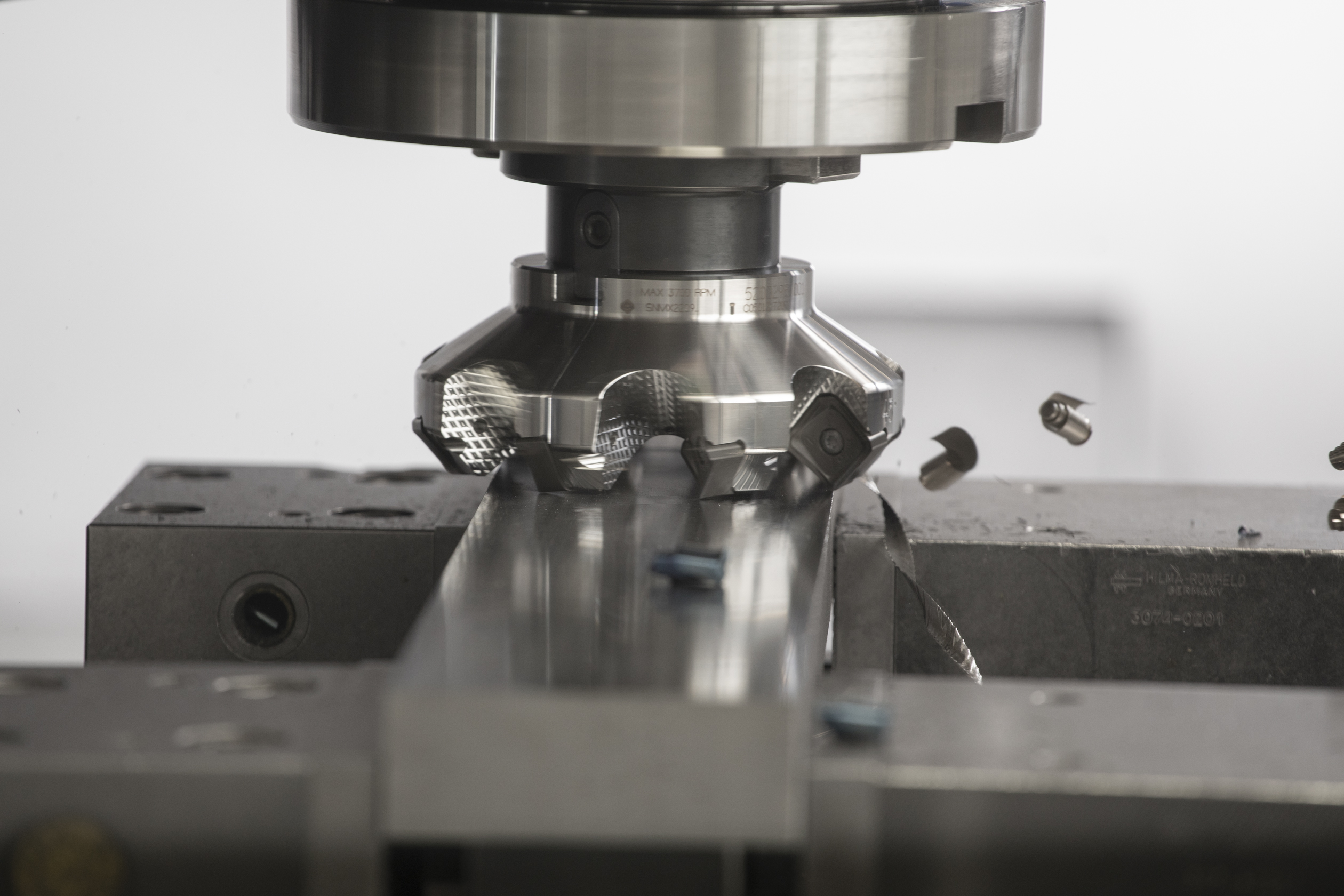

Shops gain the ability to facemill with less force and take full advantage of their machine tool spindles' capabilities through increased cutting widths, depths and/or feed rates. The key to these performance advantages lies in using the right lead and rake angles. When cutting tool supplier Seco Tools developed its latest Double Quattromill 22 and 14 facemilling cutters, for example, it opted for dual lead angles of 45° and 68° cutter bodies.
A 45-degree lead angle produces better chip thinning, higher feed rates and more bidirectional cutting forces.
A 45° lead angle on the Double Quattromill 22 produces better chip thinning, higher feed rates and more bidirectional cutting forces.
These dual lead angles accommodate medium to large DOCs and enable shops to choose the cutting force options that best suit their individual workflows. A 45° lead angle on the Double Quattromill 22, for instance, produces better chip thinning, higher feed rates and more bidirectional cutting forces, all attributes that suit situations with unstable or weak fixturing. The 68° lead angle of the Double Quattromill produces higher DOC capabilities within the same inscribed circle diameter. Its chip thinning performance improves on 90° lead angles while it offers greater ability to avoid sidewalls or fixturing than a 45° lead angle.

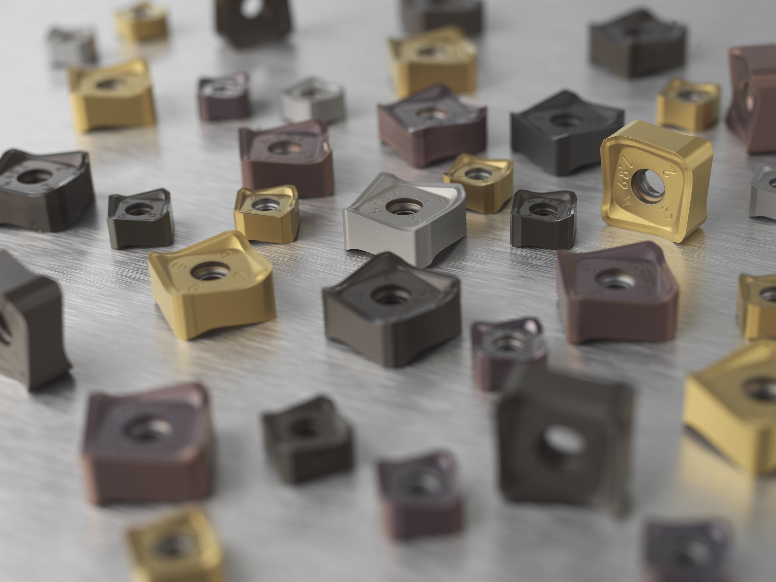

Insert geometry options further enable shops to specify their facemills and inserts to match their workflows. To make the Double Quattromill 22 and Double Quattromill 14 applicable to a broad range of applications, Seco Tools offers three choices of insert geometries. Double Quattromill 22 includes ME12, M12 and M18 while Double Quattromill 14 uses ME10, M10 and M16. These geometries boast capabilities that lend themselves to working with specific types of machine tools and materials.
ME12 and ME10 provide a sharp edge that creates lower cutting forces than M12, M10, M18 and M16. As a result, ME12 and ME10 work well with lower horsepower levels, and are well suited for sticky materials such as titanium and stainless steel.
M12 and M10 have sharper edges and smaller T lands that create less cutting force than M18 or M16. This reduced force excels at lower spindle horsepower levels, while the M12 and M10 do well with sticky materials, some tool steels and superalloys.
M18 and M16 provide the best edge protection when machining abrasive materials. These geometries are well suited to steels, tool steels and cast irons.
