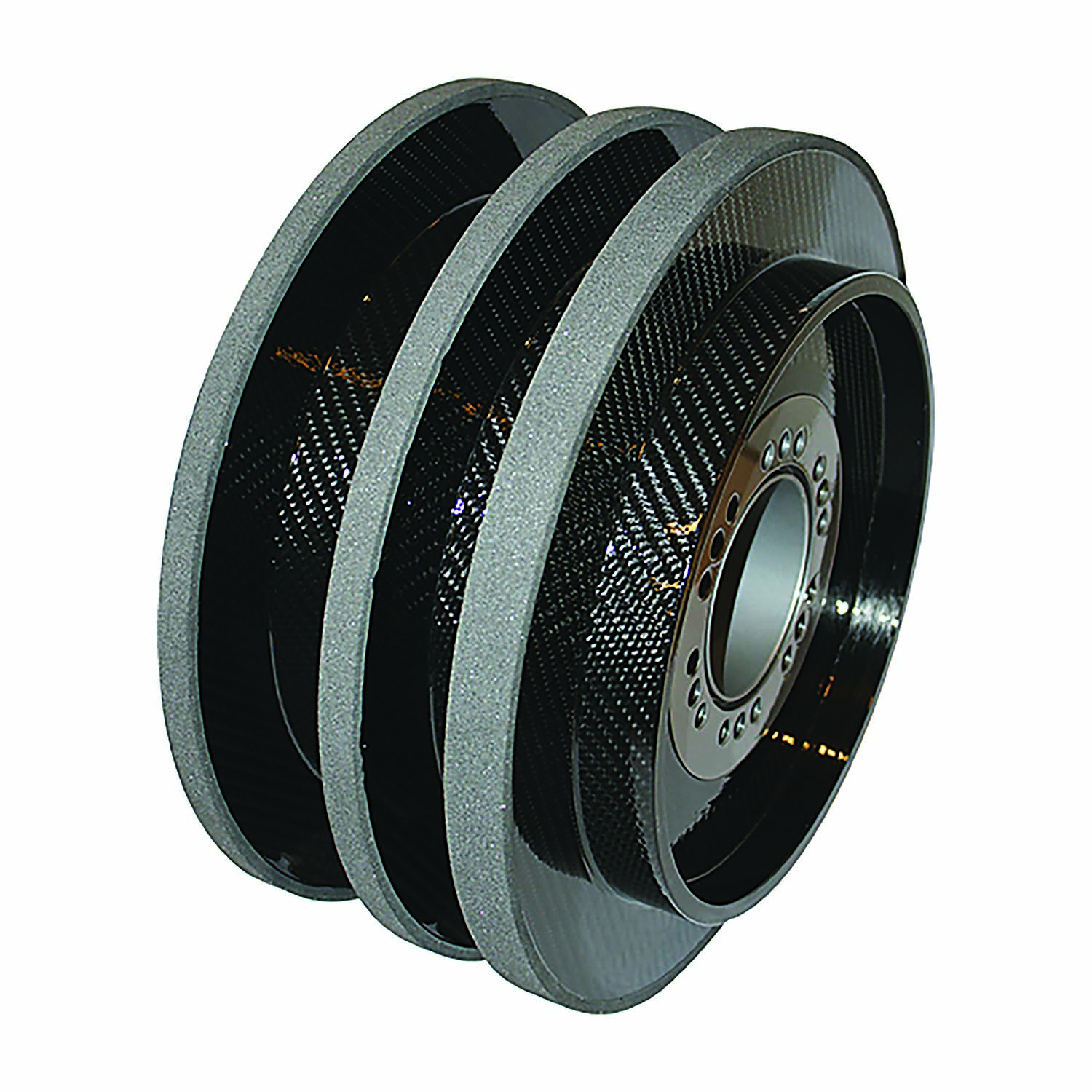

Norton Winter CarbonForce uses a carbon-fiber hub, which reduces the overall weight of the wheel. Image courtesy of Norton | Saint-Gobain Abrasives

Similar to titanium, in recent years carbon fiber has been used as a core material for vit-CBN wheels, which considerably lowers their weight. Although this could help reduce spindle requirements, it comes with a higher price tag that may be difficult to justify in many cases.
