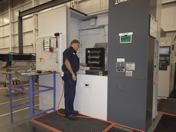

I started with the HMCs as they are more critical to production. Each HMC has two pallets. To establish a common foundation and maximize flexibility, I selected two four-sided tombstones for each of our two 500mm HMCs. Having four available sides allows simultaneously setting up multiple parts or accommodating parts with multiple operations. I selected a two-sided tombstone for our 600mm HMC machine.
All five tombstones have a 2 ” hole pattern. Each hole is bushed to accept a 5/8 ” dowel at the top and has a 5/8-11 thread below the bushing to accept a screw.

Doug Wheeler, a machinist at SMW, prepares an Okuma MA-500H for production. Note the four-sided tombstone with multiple fixtures attached. Image courtesy of SMW.
